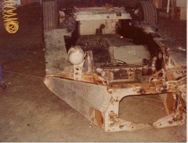

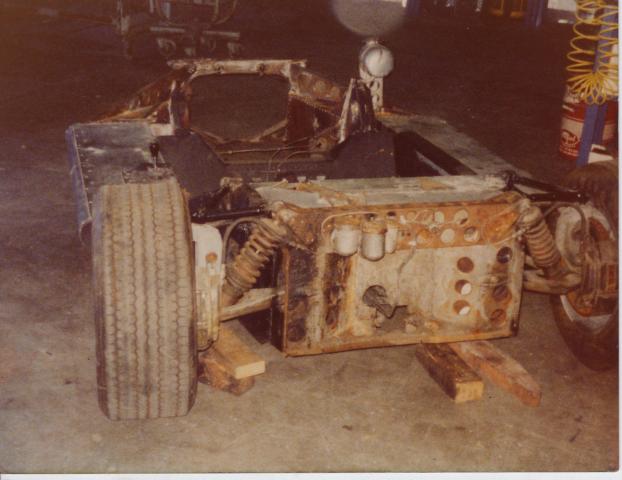

For info, I have attached two images taken in 1975 of the chassis no. 37. As you can see she is a Mark II with R & D mods.
You will notice that the fuel pods, centre bulkhead section (which has been heavily strengthened in steel) etc etc had been modified well before this time.
I have other photos which show that the roll bar towers have been modified to allow more room within the engine bay.

Seems a simple matter if you can prove (within reason) that the chassis in the pictures is 37 and also the basis for your current chassis. If it were my car I would not go with a semi automatic even if it turns out to be 37, which I hope it does!

Yes, without doubt my car has the chassis 37, John Mason did an incredible job in restoring her and patching up her wounds which are still clearly evident today.

We had a dummy run this morning and it appears that the engine will fit, as mentioned before the centre section has been seriously modified (cut away) and reinforced with steel together with part of the floor.

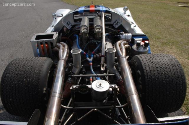

Johan, Do you still have a set of t-70mk.3b wheels for sale? I plan on building one before I die and the wheels do make the car. I am willing to do whatever it takes to adapt them to the RCR hub/upright ect. Not afraid of having to run Avons or some other race only tire either.

I have a nice old original non-corroded magnesium set and a set of treaded Goodyear tires that we raced on last year that are pretty much worn out heat cycle wise but have tread pretty much all the way across. The tires are free if you want the wheels... and there is no rush.

GREAT! I ,of course am in the process of selling some children and toys I've grown bored with (what recession!?). It seems to me that Fran said that their WILL be pain involved with the adaptation of the correct Lola wheels. I hope it wont cause too big geometry and/or roll center problems. It absolutely MUST have the right wheels(and left) installed.

At the least it is an upright problem. The rear wheels are so deep at 17" or 18" that the upright becomes fairly specialized in order to reach the hub and clear the rim/tire and then the tire has to clear the chassis and bodywork. You would have to use 3b uprights or Formula 5000 or whatever. I'm sure Fran could guide you. Lots of used parts are out there because race cars constantly get new parts put on them but then you get in to a quality issue and a safety issue. Then there is the brake situation and the money issue, but I agree that the wheels make the car. I have a set of 14" wheels that look the same as the 17" wheels from the outside, but the most straight-forward solution would be to use 3b uprights, hubs and brakes.
