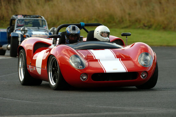

new picture of my GD T70 on track
nice new picture from last friday on track with my GD T70 which (touch wood) is going very well at the minute. probably my last trackday of this season though now with winter looming! roll on next season.:thumbsup:

i've done two small club sprints already (non msa) and placed 4th and 5th overall out of 40 cars (barkston heath sprint track) so that was satisfying as the tight twisty track isnt really suited to it. next year all being well i want to start hillclimbs and sprints, possibly the Isle of Man Classic 3 day event if all goes well as a start event.
other than that it will be just trackdays etc rather than circuit racing, i'm not keen just yet on paint swapping on track and also not sure what if anything it would be eligable for in terms of circuit racing.
its been a long journey as the car span a bearing last year after 3 events and required a new short motor, and then this last month the clutch let go at silverstone trackday in spectacular fashion, so its not had enough use yet!

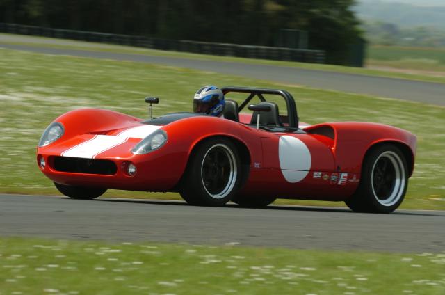

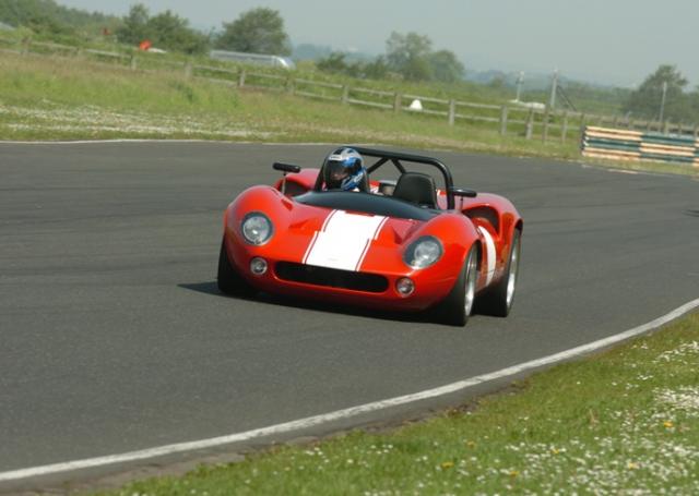

thanks Ron. i think i posted some links previously to some build pics on photobucket, i also have a couple more recent ones i need to update from this season which i've attached. i'll try and find the photobucket link as it has some build pics but not all.
