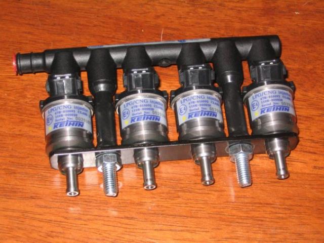

Well well well...
Lookie what Brian found...
Peak & Hold Injector PQ2-3200 (Gaseous Injector)
$225.00 each, so 4 would be right at $900.00. Direct swap is what it looks like to me. Of course you'd have to redo your fuel system, but still. Pretty sweet stuff!!!
Whatcha think?
Whatcha think?
Brian, I'm nearly sure that's the Keihin LPG/CNG injector, which you can buy from any Prins dealer for about a third of what RC are charging. In the pic below they're mounted in a common LPG manifold or rail, and are setup for running flex tubes from the barbed nipples to the manifold runners. They're also available as per the picture on RC's website, for direct manifold mounting (replacing the gasoline injector) Standard import injector mounting, and they use the Honda type injector clips. Very high quality kit.
Warning: Rant mode on. Sadly, advanced LPG injection systems from Europe aren't available or approved for use in the USA for aftermarket conversions because our government essentially put the aftermarket LPG conversion industry out of business back in the late 80's by mandating EPA certification for them on an application by application basis. This meant only the OEM's could afford to provide them as EPA certification is a very expensive process (similar to CARB certification). At the time, the Big 3 didn't have much incentive to develop this niche so it essentially died or it was limited to a few fleets of busses, delivery trucks and a few F150's for individuals with deep pockets.
Hopefully the next occupant of the White House will relax some of these onerous restrictions, and will encourage the redevelopment of the aftermarket LPG conversion industry, as the infrastructure for distributing LPG to consumers already exists. And no, I am not related to the LPG industry in any way; I just resent it when a government interferes with industry to the point that innovation becomes stifled. OK, rant mode off.
