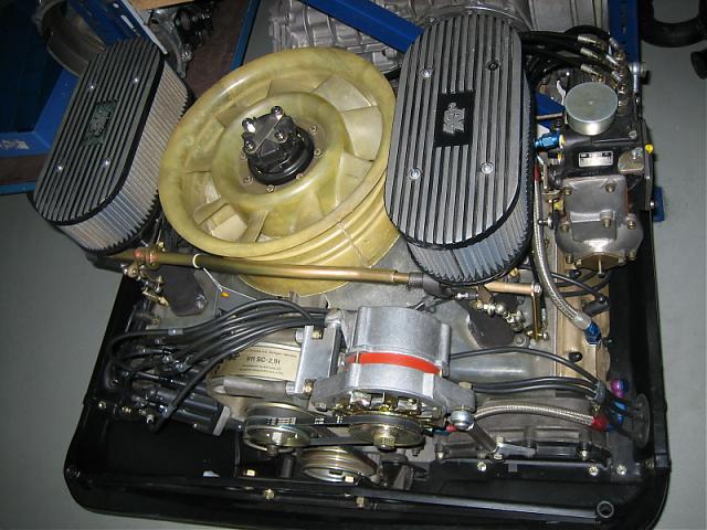

what your looking for is a 935 fan. If you could find a 935 parts book, its all there. I belive its almost 200 separate pats to make this up.
Mark
Old 934 RSR racer
Name:	MY RSR 3.6 -1.jpg
ID:	26282  Click image for larger version
Name:	MY RSR 3.6 -2.jpg

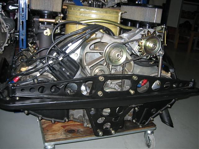

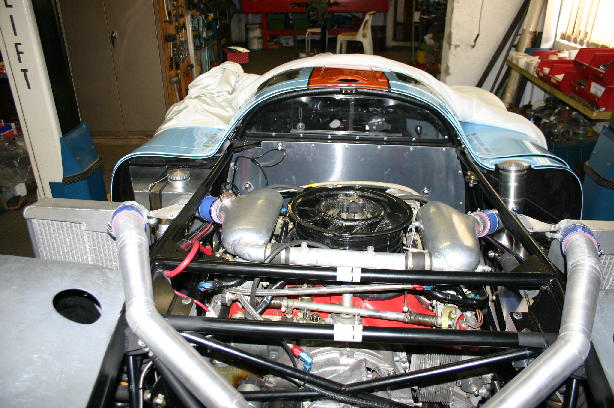

Saw a real 917 once and WOW! Have fun building it, It's totally worth it! - Have a great time! Here is the pic of the engine I took!

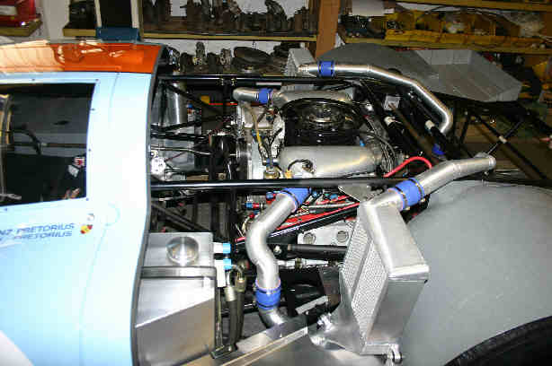

The one change I will make to the 993 is to have a horizontally mounted cooling fan like the original 912 engine. I'd appreciate any thoughts on how to do this. I have seen some photos of more contemporary flat-6 Porsche racing motors with a horizontal fan - anyone know how this is driven, and what shrouds might be available?
Craig, here are some pictures of a 917 with a 935 twin turbo 6 cyclinder. Note location of twin intercoolers. I would have moved the turbos closer, seems like they are to far back.
Enjoy, Mark
