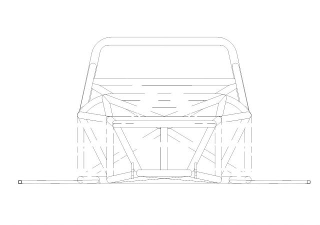

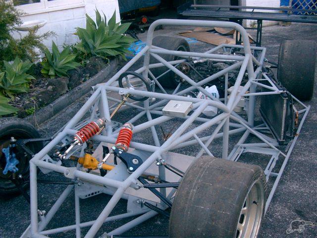

new build a Porsche LMP
hi guys , i have made a couple of posts already and was wondering where i should realy be so to speak , and as i'm also building a Porsche i hope you dont mind if i join you here.
the car i'm scratch building will be a copy of the Porsche 1995-96 WSC LMP car run by Joest racing
the chassis is 95% complete, just the rear shocks to mount etc and alloy paneling, then its ready for auxillieries to be fitted
power will be a turboed 3ltr 6cyl Subaru engine and transaxle, i have thought of fitting a bent 8, but the cost of a trans axle etc would be just a little out of reach at this time , but is certainly an option in the future.
my aim is to get it to a rolling chassis , fit the engine etc and then start the hard part and build a body.
the person who designed and built most of it so far has not only all chassis and related parts on a CAD disc, he has also done all the body profiles to be CNC cut to make a plug, and to test his drawings he has had a full set of panels laser cut out of 1mm zinc plate in 1/4 scale and assembled a model and it fits together perfectly,
and underneath it all is a scale model of the chassis.
so with a fair bit of luck and hopefully some help and advice from you guys, i might get a half decent body built one day.
i have started a photobucket site of build progress , link here
stryka_01/Stanton WRC-95 - Photobucket - Video and Image Hosting
so feel free to drop in and check up on me , and let me no if i'm heading up the wrong track.
cheers John

Any idea what the undertray looks like? Does your chassis design/config copy the undertray as well?
Thanks for sharing your interesting project - I know many folks will keep a keen eye on your progress!

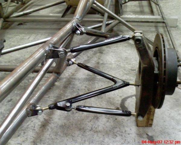

A question - Where/what car did those front uprights come from?

I am curious about those front uprights - it looks like there is a big spacer under the lower ball joint interface. Would that not cause a considerable bending moment under lateral load?
Second question regards the chassis - it seems like you could put a little more structure to the outside of the car? That would serve to offer more side impact protection (unless the body is designed for that) while also helping to stiffen the car in torsion and side bending. It looks stiff as a brick in beaming.

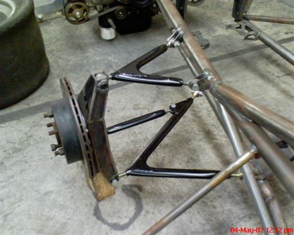

thanks for the support guys, to answer a couple of questions.
yes the drawings cover both front and rear under tray.
the front uprights are mazda Mk 4 RX7, as are discs and calipers
rear is custom uprites with Turbo skyline hubs and rotors , with willwood 4 pot calipers.

Tom, valid points. Will there be a bending moment? Yes. Is it significant? Probably not, bearing in mind the weight at the front of the car. Remembering also with the standard setup there is a bending moment too. With the lighter front the moment is probably similar.
Could a little more structure be put to the outside of the car? Yes. Would the gains offset the losses? Probably not. John has not said what the purpose of the car is, but I bet its being built to run in our New Zealand Sportsrace Car Series in the Supersports class. The number one enemy in any race car is weight. I think the compromises made are just right. I'm sure it will be a very quick, good handling car.

as for the bottom uprite mount spacers , they are cnc machined out of 4140 and are 30mm dia, a heluva lot stronger than OEM set up.
some of you might also think the front of the chassis from the pedal bulkhead fowared is lacking in triangulation, i no i did, but Bruce pointed out that what Andrew has done very cleverly, is make it a crumple Zone, so on a big frontal that section will collapse before the cockpit starts to move.
As Russ pointed out, with all race cars theres always a compromise between safety and weight, and i feel quite comfortable with how its been designed and built so far, and in Bruces words, it should be as Stiff as a school boy on his first date, what ever that means, i cant remember.

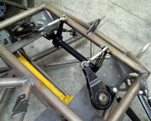

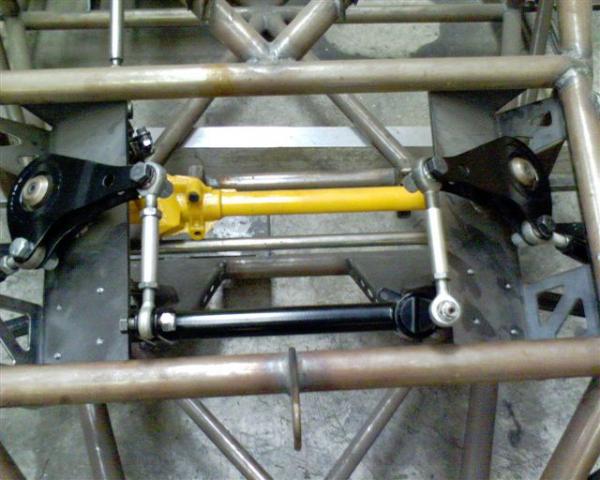

a couple of pics of rear uprite and wishbone set up and front adjustable sway bar, i have mounted the calipers on the rear uprites but dont have a camera at present[ away getting repaired].will post updated pic when it returns.

How did you come up with your suspension geometry? And i guess the trans is just a Subi trans? Not a Porsche box or anything?

Old 05-08-08, 06:09 AM   #19 (permalink)
kaspa's Avatar
kaspa
New Zealand
Join Date: Apr 2008
Location: Feilding NZ
Posts: 135
Rep Power: 2 kaspa is on a distinguished road
Re: new build a Porsche LMP
well its taken awhile but i have finaly worked out how to undress the main chassis file, so now its down to bare bones so to speak i have posted some pics to get an opinion from the technicaly minded.
just be awhere there is still one x brace and probaly a diagonal to go into top of engine bay.
appriciate honest opinions
roll centres ive worked out as accuratly as i can, with bad eye sight and an old slide rule at 40mm front and 50mm rear, center of balance with engine installed, wheels on , no fuel in tanks etc just as it sits with me in the seat, is directly under my bum or approx 300mm in front of roll bar bulk head.
Cheers John
