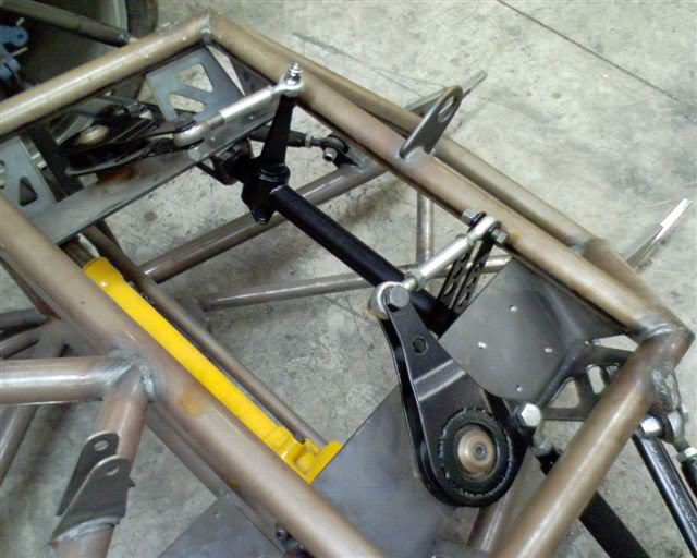

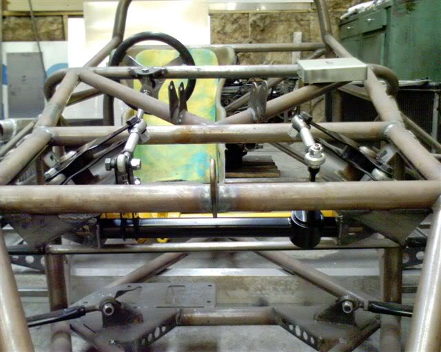

Hi, great build. I have a couple of questions about the front anti roll bar. This setup is what I am thinking on my SLC rear in the future. My guess work so far, and that is exactly what it is a huge guess, is that I need something like 50% of the spring rate in roll bar rate. If I run 600 lb springs in the rear I would be going for about 300 lb bar. Then I would want to adjust up or down 20% or so. Lets call it 250-350.
My question(s) are what kind of material are you using for the bar itself and what rate is it at full hard. Then how long and what diameter is it and how much do you expect it to twist. Also I really am not sure what I need to ask so any good stuff on your calculation/thinking would be really helpful.
Again I love these kind of builds. Great powertrain choice and really cool concept. With that much tire it ought to really have a huge amount of grip.
Howard, the blade was machined out of a piece of 4140 and is 6mm thick and 84mm long, at full hard it would be solid, I did have it written down somewhere how much torque it took to move it on full soft, but I have no idea where that would be now. I no it wasn't excessive, that's about all I can help you with sorry.

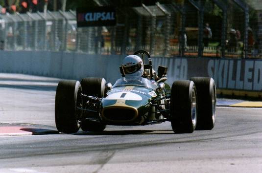

Found this and trying to attach a pic of BT24-1. Here goes
Brian
Thanks Brian there is some really nice pics of 24 's out there if you look around,
