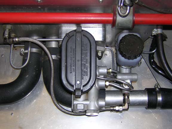

I replaced that master cylinder with a tilden that has the same bore size.

I did get a longer stainless line and the Tilden has the same bolt pattern as the one I removed.

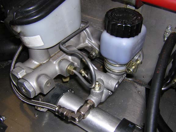

I guessed (perhaps incorrectly) that the reason for it being a flex line is that since it is so short, there might not be enough rrom for the hard line to absorb movement. You could always install a circle or two to take up that movement, but space is limited here. I'm probably wrong, but that's what made sense to me.

Please remember that the picture above from Hershal does not use our clutch master cylinder. Our master cylinder has the output line coming out at 45 degrees / upwards at the bulkhead the master cylinder is bolted to. This greatly restricts the space and the use of the flex line is real useful.
The position of the through bulkhead fitting that Hershal used is also in the wrong place in comparrison to our factory fit. We recommend that the break and clutch bulkhead fittings are outboard of the master cylinders.

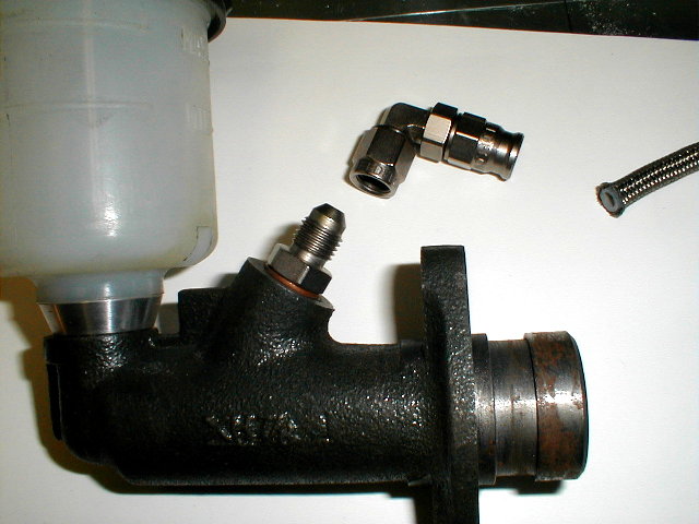

Hey guys, I'm bringing back this thread because now that I have Ron's old car (my new one!) /ubbthreads/images/graemlins/smile.gif I face the same problem he had. It seems that there is a part missing that adapts the fitting that screws into the master cylinder for the clutch to the braided hose provided in the kit. I went to all of my local auto parts stores and could not find anything that worked. Did RF provide this "special"part in your kits?

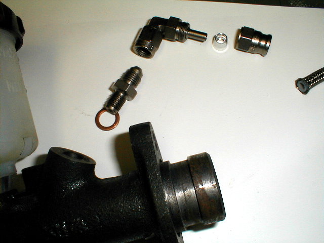

Hello again Dan, I took my set up and took a good look at it for you. Its a -4 90 degree superflow fitting. It goes from a 37 degree flare to the -4 braided teflon flexible hose set up. I took it apart in the second pic, and you can see the ferrule as well. Any commercial hydrolics outfit should carry it, or be able to get you one. I saw the superflow stuff on a big chart just today at a outfit I visited.

The fitting in the master cylinder goes from a straight , to the male end of the 37 deg. with a crush washer to seal.
Hope this helps, regards, Dan W. /ubbthreads/images/graemlins/smile.gif

I just looked at my setup again, and its also the same fitting as what is on the other end of the braided hose to the bulkhead fitting,,, a 90 deg, 37 deg flare to ferrule/"collar " hose setup. So maybe you have that end you can take and find what your missing. /ubbthreads/images/graemlins/crazy.gif
