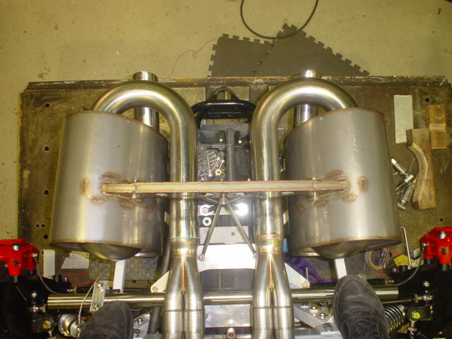

Whilst I, like most of us I expect, want to maximise power and torque, one of my primary requirements is to minimise noise from the system, could someone just confirm that the "cross over" system is the best way of acheiving this ?
Iain

I have run both non cross over and cross over systems on my car. There definately is a difference in noise output but is one quieter than the other? I think smoother is a more useful word here as the riffling of the gases was possible on the cross over and not in the non cross over system. Maybe that did make it a little quieter? Both systems passed the Goodwood static noise test. And both systems need repacking every so often especially if you go to high RPM regularly if you want to keep meeting the circuit noise regulations.

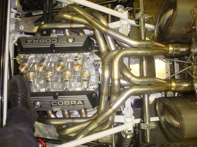

IMHO, firstly the exhaust headers/ primary's on a gt40 and any lookalike cars could never be described as a 'bundle of snakes' and the orderly manner in the way they are frequently designed is a very clever skill. (visualize some of the really good ones that Tony Law made). Secondly, any V8 with twin silencers/mufflers with 2 left and two right side cylinders into each silencer sounds (SOUNDS: A VERY SUBJECTIVE TERM) so much better than any other configuration. In fact it's almost a sexual thing.

Mine looked like this before it was taken apart (again)

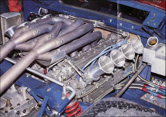

Here is a picture of a Ford DOHC Indy engine in car GT40/103. It is easy to understand why later GT40s with conventional V8s continued to have the crossover headers called a barrel of snakes. I think that description is part of the lore of GT40s including other “special words” like twin nostrils and Gurney Bubble.

It's a "Wonder" they ever fitted under a rear clip Bob!:D
