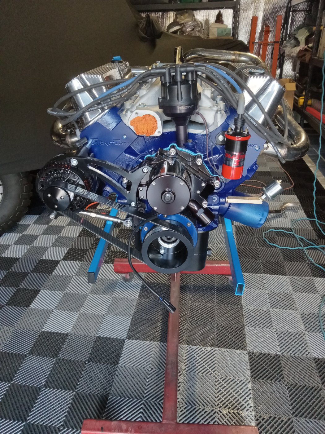

Question(s); What are people typically finding the best to use for spark plug wire sets as the relate to clean routing around the exhaust bundle of snakes pipes? Do the prep built sets work good? Or am I better off with the universal set that requires cutting and installing the coil boots to route around the pipes? Also, do we find the 90 or 45/135 degree boots? Anyone using a spark plug heat insulating boot too? Like these; Spark Plug Insulating Boots
Thanks, Ben

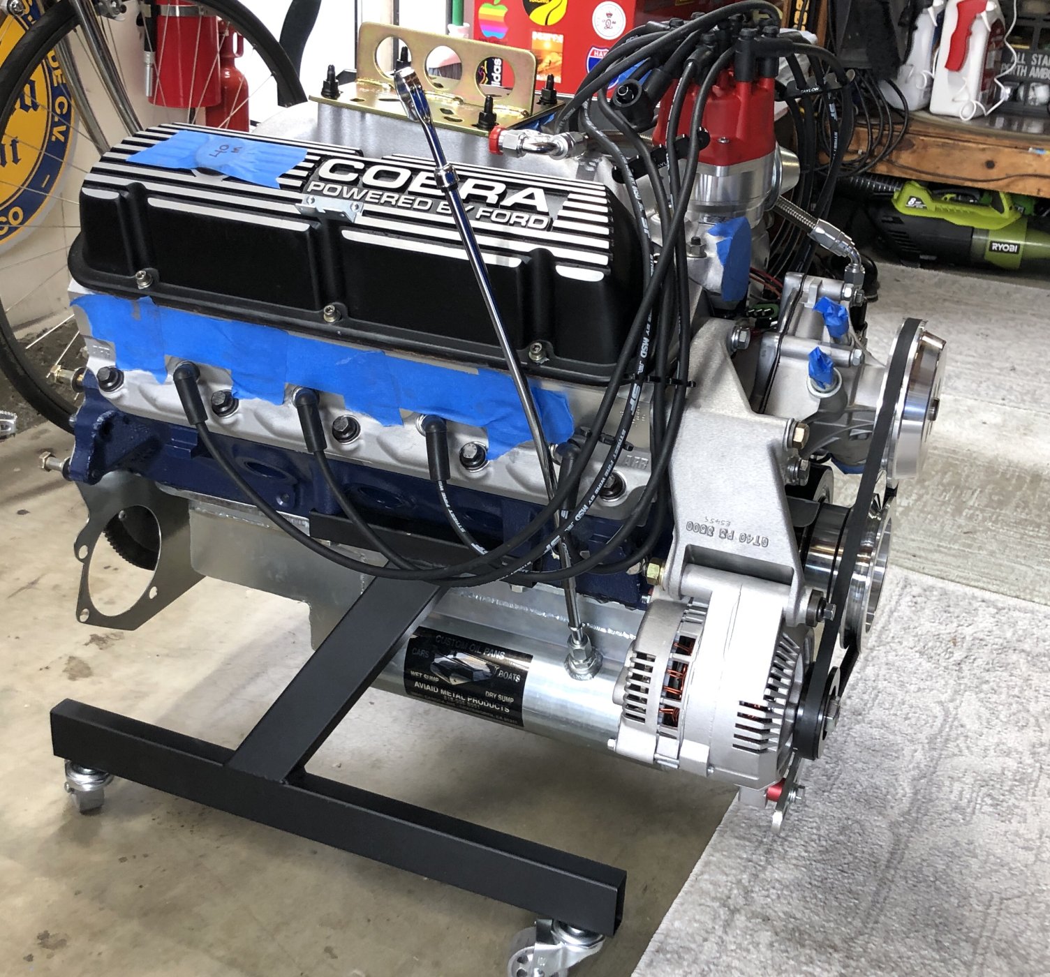

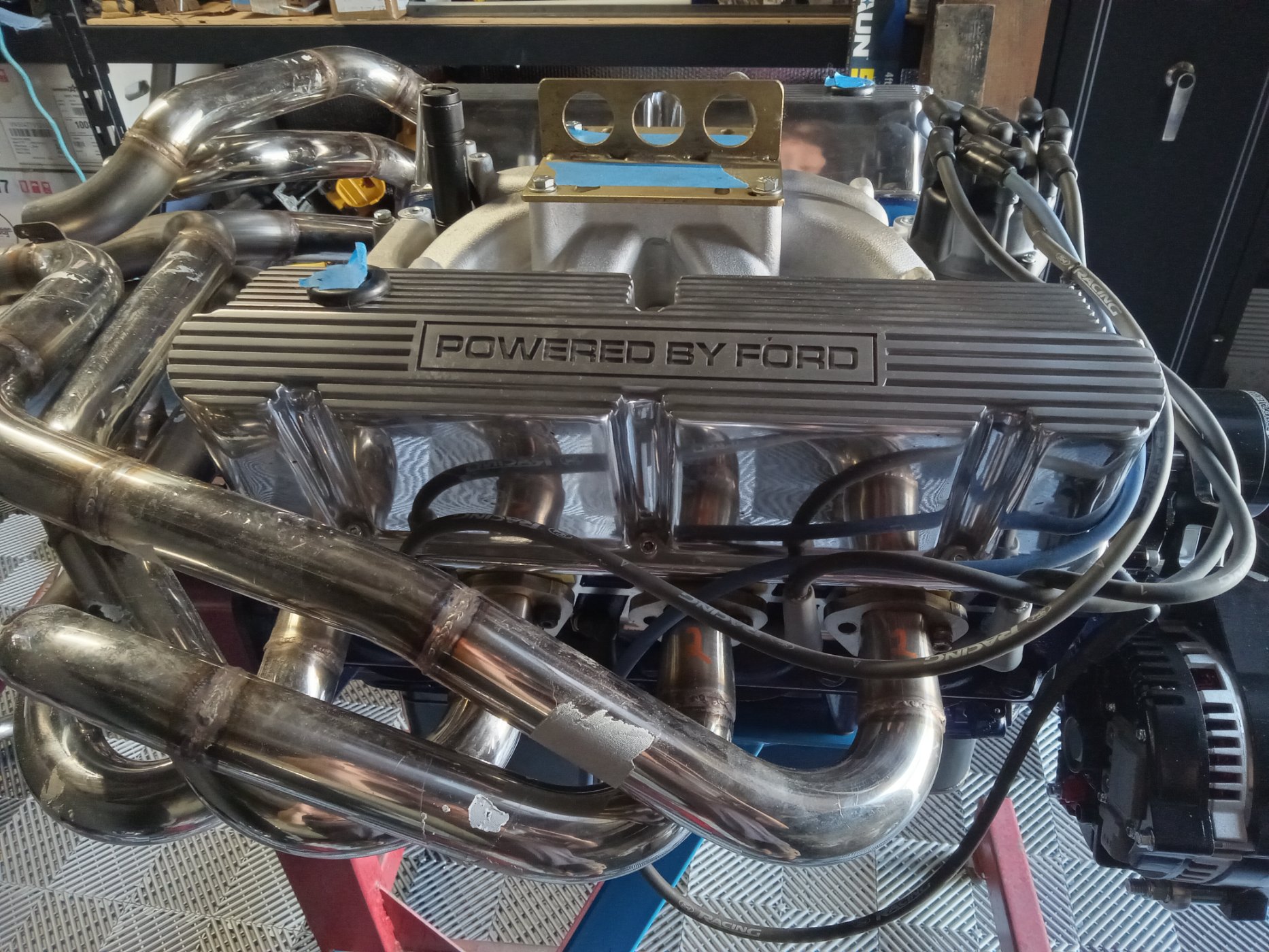

Use a universal set. Roush uses wires from above on their crate engines, but mine got burned in short order. Best to run the wires from below and use 90 degree boots with insulating covers.
Davidmgbv8
I got the all black pertronix set that you make to length for a more OEM look. I could not find the Ford orange wires..
