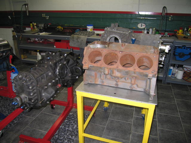

Just a very major service. We'll inspect and restore as necessary but we don't forsee anything too problematic. We will open the motor but aren't expecting much. The tub is totally fine. The clutch is fine but we'll replace it along with brake pads, tires, hoses and belts. The T-44 is fine as well. A good cleaning, replace bolts, etc. Touch up the paint and heatshielding.

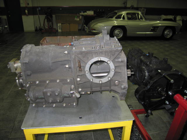

In the picture of the transmission there is what looks like a Gull Wing Merc. Does it have a secial history? Any more pictures to share?

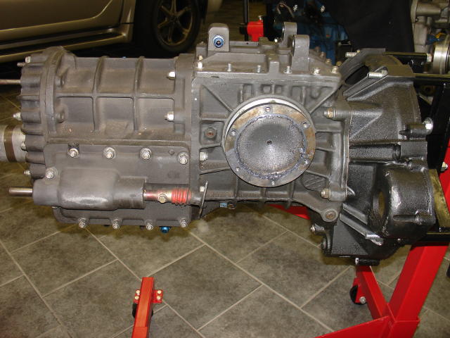

Could you tell us some more about the auto t44? Did it ever race? How did it do if it did? Have you used it in your car at some point? Where did it come from? Do you have the other parts, bellhousing, torque converter, coolers, shifting mech. Is it ment to be shifted from gear to gear when raced or just left in "drive" Does it have a little plate for the dashboard PRD21 or somthing like that? Does it have a "park", reverce?

I got these notes from Lee Holman on the auto tranny:
[ QUOTE ]
The auto used the same ring gear, pinion nad front case but all other parts were very different. This was a product of the dyno test which showed the GT 40 Mark II did not need to change gears that much so why not make it a 2 speed and have the trany change when needed. They did not work as they should and a lot of money was wasted on them.
[/ QUOTE ]
I don't believe it ever raced. I have tons of spares none of which are for sale. They came with J6 and were aquired by her former owner Peter Lavonos. He told me the auto was all that was left of J2 after Mile's fatal crash as the rest of J2 was destroyed (By Lee Holman) as was J1's tub at Kar Kraft (By destructive testing on chassis dyno).
J6 of course has her original manual T44.
