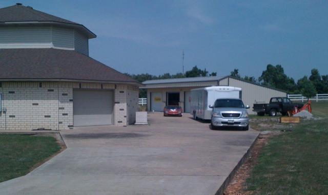

PS: Crummy picture, but you get the idea of my truck and trailer.
That's Mike Trusty driving his GT40 for the very first time at Jack's house back in July!

Already done, four of them, you can seem them peeking out under the trailer and the open tops to them. Weight at the hitch.
There isn't much room for moving the car. We did that the other day to the max aft limit and it helped by 150lbs or so, but not nearly enough. The Z is 50/50 so loading backwards is not any help.
New Race Rig
