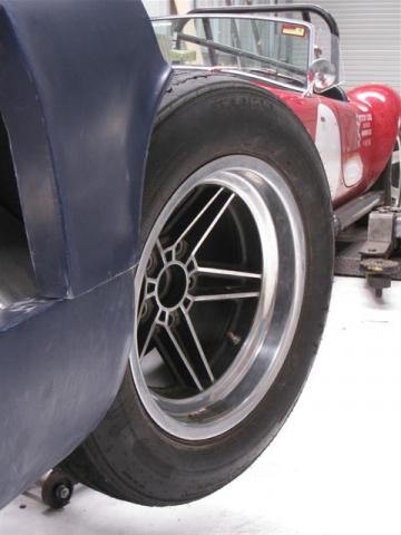

Finally found a couple of almost Lola wheels , they're 15x10 Mg (by Rebel Australia --but no longer in business) there's more out there some where

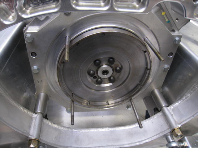

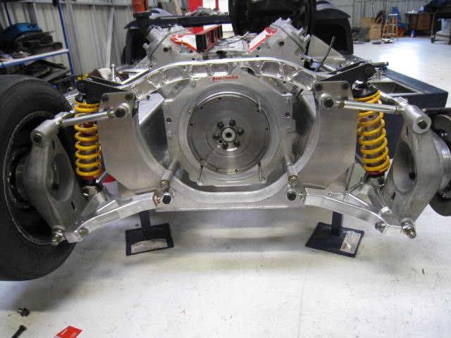

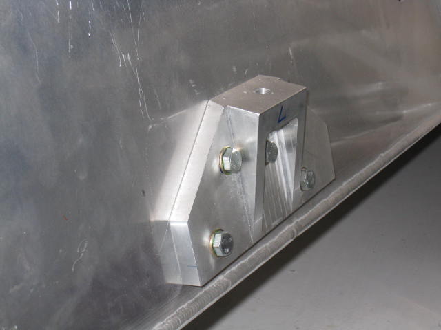

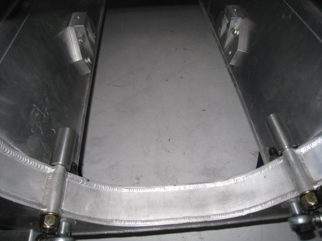

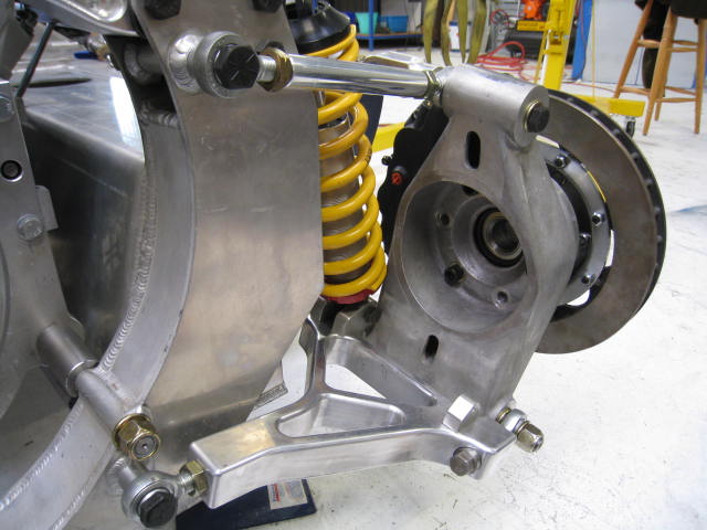

Been a while --almost forgot where me post was --a bit more fiddleing --but it is progress. It's a roller, now to fit the rear clip --and its off to the plumbing shop for some exhaust pipes --$$$$

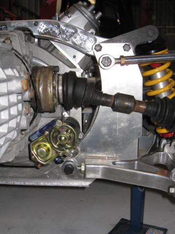

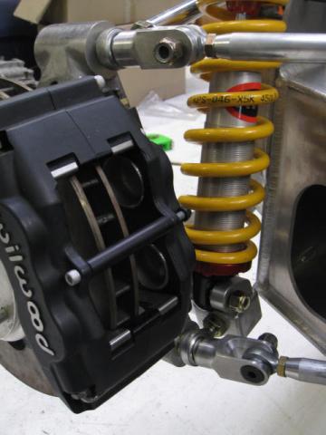

Ron , the wheels are 15"dia. x 10"& 8" bolt up face is about central--bolt PCD just happens to be 4.75" (corvette) --they were a locally (Aust) made item from the '70s thru to late '90s --now suddenly they've become rare ?
The CV shafts are a common GM product that I have shortened --not sure if its gonna work yet

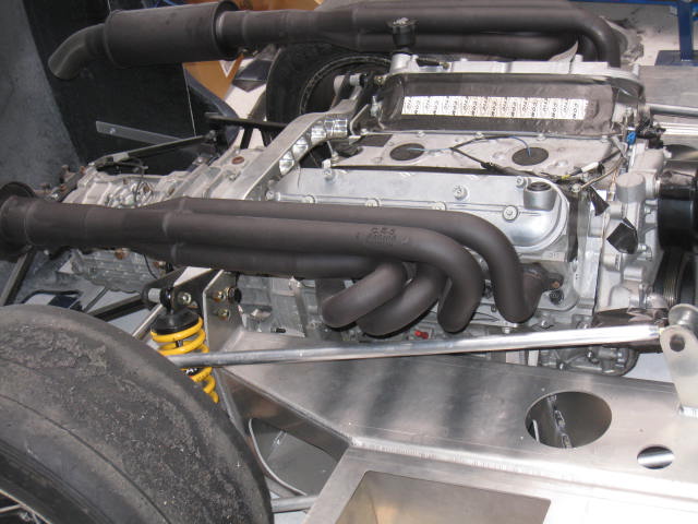

Beetling along ---exhausts done

Trevor did a great job of your exhaust.
Looking good.

Chris,
Are those RCR uprights? They look like they are cast.
Jhncaj is offline
Old 08-06-08, 02:53 PM   #157 (permalink)
gt40fran's Avatar
gt40fran
Sponsoring Vendor
Location: Manufacturer of
GT40: Michigan,USA
Posts: 3,036
Re: Another first...Australia
They are not RCR......
Chris chose some wheels that were not suited to the stock RCR suspension...and as he is pals with DRB. and makes parts for them he was able to modify things and use them to allow wheel fitment/clearance.
