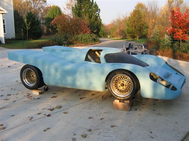

A few pics to show the early progress of the 917.....we are further along now but you guys cant have it all at once....hahaha
These are pics of the second chassis being built .....from original prints no less and many many hours of research.
The chassis dimensions are a match to the original 917 chassis...
Also the body prior to being final surface sanded and more moulds being done....
Spectacular shape and as close to real as you can get...based on panels from David Pipers 917 chassis number 10
well done Brad...(RCR body and mould magician)

Anorack question
Are all the pipes drilled before welding and then pressure filled to ensure no cracks?
Whatever the answer it looks amazing!

I was wondering if the tubing is mild steel or something a little more exotic, like 4130. I was also wondering why there are two identical threads on this subject.

The tubing is 4130 ....there is no reason to pressurise the tubes as this was only done to show cracks in the marginal original alloy chassis tubing...
Mark,
the reason for my double post is that some people dont always read each and every forum, as you pointed out in your reference to condensing the forum subgroups...and I would like to share the RCR917 progress with as many people as possible....

Fran, is the rear/frame set up for a SBF or a porsche engine? As I recall, the 917 engine was a boxer 12 of somewhat larger displacement than the 911 engine engine of the day (2.2ltr)...?? I can't remember how the horizontal fan was driven but probably not too difficult to replicate this somehow on a 3.0sc engine as a starting point. Related, it seems to me the fuel was supplied via tall stack mechanical FI - that'll be expensive to replicate. Webers or PMOs would probably look pretty similar and be relatively inexpensive.

The 917 engine(912 designation) has a bevel gear driven fan, this gear is located half way along the crankshaft.
This location also serves as the input drive to the transaxle which has a shaft running back under the crank centerline to the transaxle.....this was done to reduce the torsional load on the long crankshaft.
Our chassis will obviously take a 12cyl engine and transaxle should you happed to have a spare 350-500k usd to buy one.....ouch.
We also have the mounts for the 6 cyl Porsche engines....
The transaxle we are using is a 930 4 speed unit ...originals were primarily 4 speed also.
The reason for this transaxle is that the ring gear can be flipped and the box will still bolt directly to the Porsche engine with no major welding/adapter plate/machining .
At present the car will only be offered as a TK minus and will retail at approx $100k.....
I am not concerned with SVA on this car as we are building it as close as we can and that also means all the bad stuff like a small cockpit and low groundclearance......the beauty of this car is its purity and we want to keep that intact...sorry.
I envisage these cars being track car for the most part due to the restrictions its design involves.....
Hope this helps...
