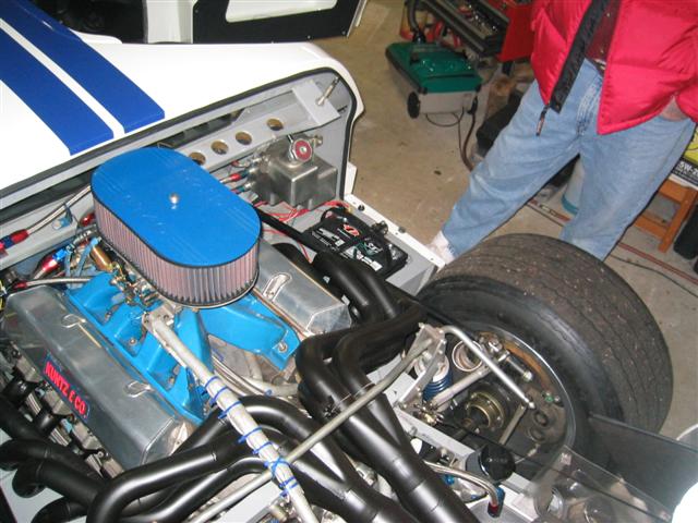

Here's a few pictures I took of a friend's MK V with the Hoosier TDs.
Name:	117_1771 (Small).JPG

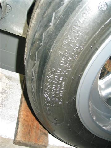

Another one
Name:	118_1808_r1 (Small).jpg

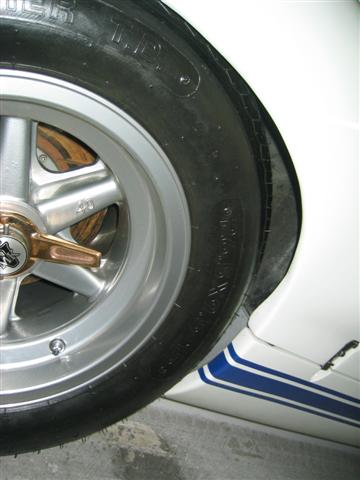

And another
Name:	118_1863_r1 (Small).jpg

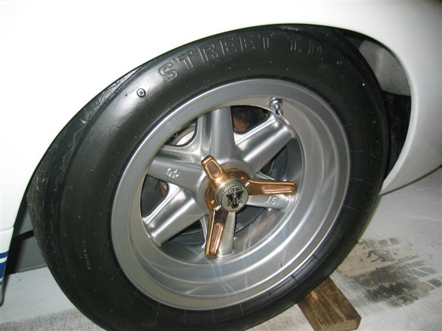

Another one......
Name:	118_1893 (Small).JPG
