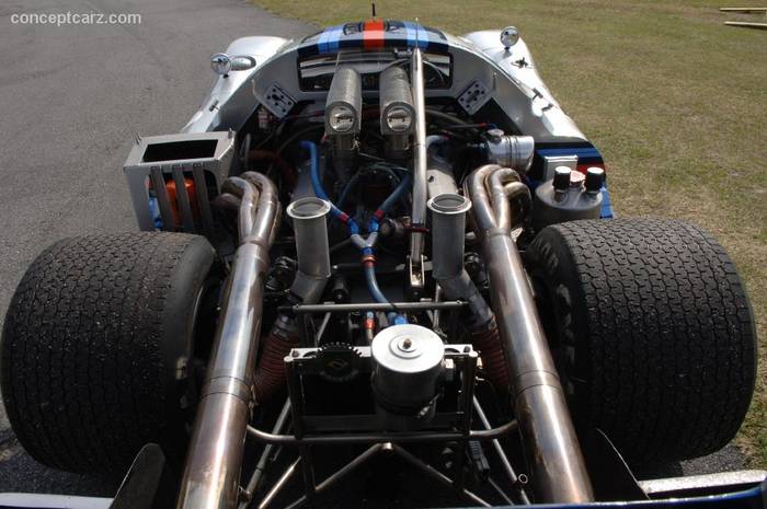

What are the largest tires I can run on this car with stock fender wells and maybe 2 inch rear flare extensions. I guess the fronts are the most difficult to fit. I would love to run the goodyear big letter treaded tires or the blue streaks but I think the tire sizes are going to be difficult to fit. I thought about the big letter avon's but I don't think they make a tall enough rear. Any ideas?
I have put Maxxis tyres on my GTD with the sizes ; 295/50x15 rear & 225/60x15 front. They are V rated and not expensive.The rolling radius changes slightly and the speedo reads around 4.5% lower than with the 265/50x15 that were fitted before.
They are obviously not racing compound tyres but perform well & look the part.
Paul
