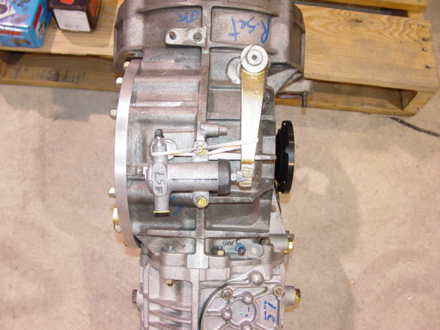

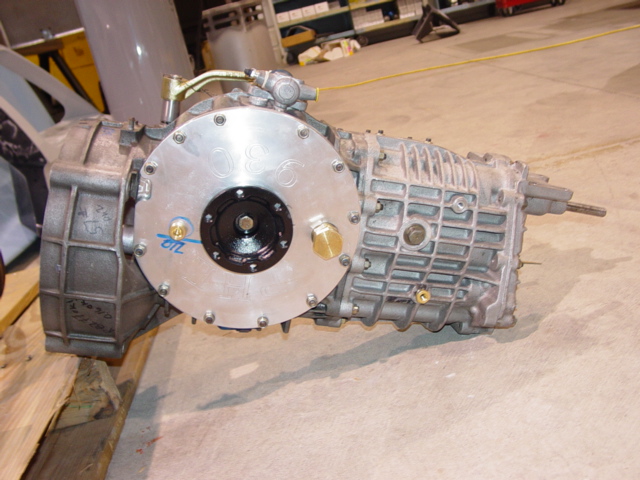

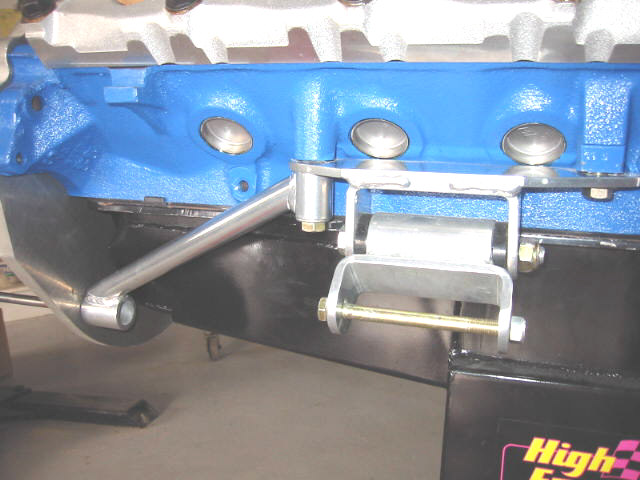

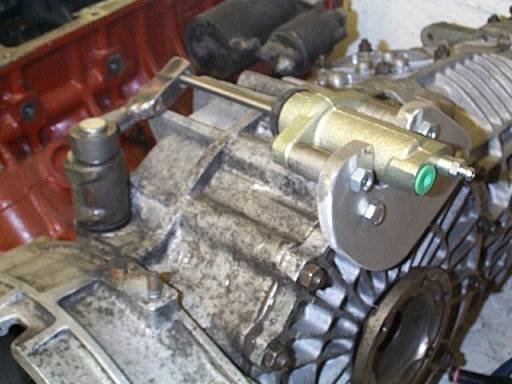

I have some old pics of the arrangement you are asking about. Don't recall whose setup the slave cylinder is from. I do know that on a DRB at least, it won't work that way as the cross member is in the way and a different angle of attack is needed, or a slot is required. At least on mine it will, but then I have moved my engine further forward than most DRBs. The support piece is from a DRB car.
