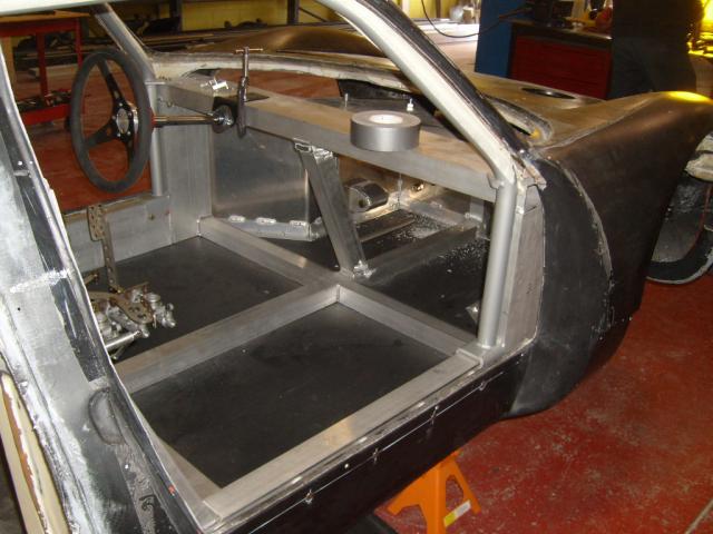

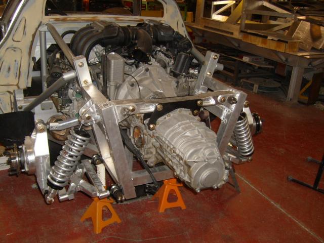

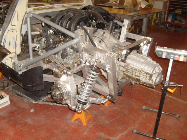

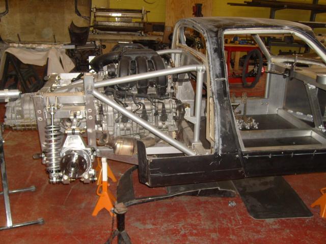

This is a trick little car....
Aluminum chassis with honeycomb floor and bulkheads...
Custom billet suspension.
Full roll cage
Six piston brakes
917 seats
Porsche Cayman S drivetrain...with 330hp....

Original was air cooled.
Cayman engine is H2O cooled.
Radiators? Where?

Single rad up front using the original 904 oil cooler opening..
ducted via a fully shrouded "v" splitter into the front fender wells...per stock Boxster...

Might want to adjust the positioning of the pedals Fran - looks like that brake pedal could really spoil the wife's fun......

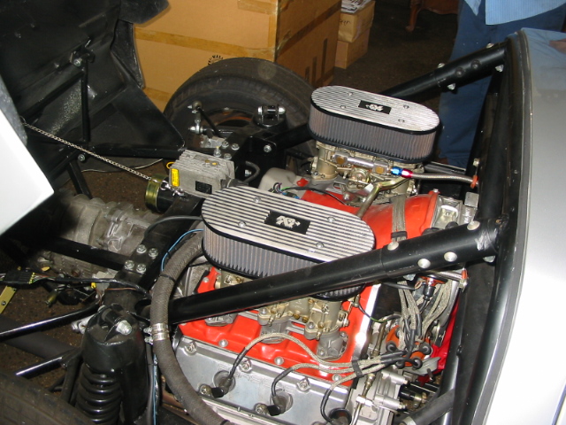

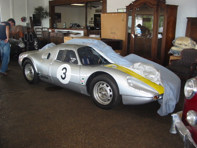

The real thing . . . .

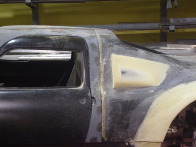

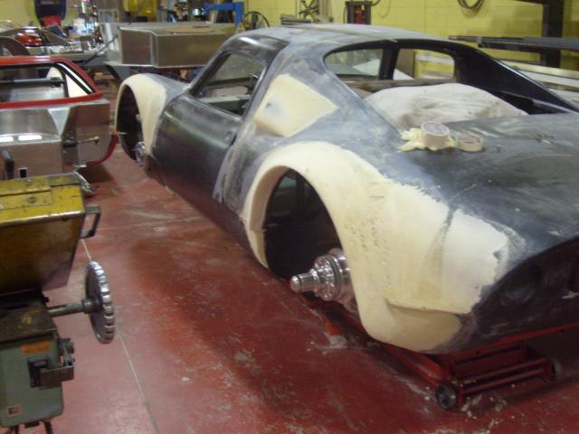

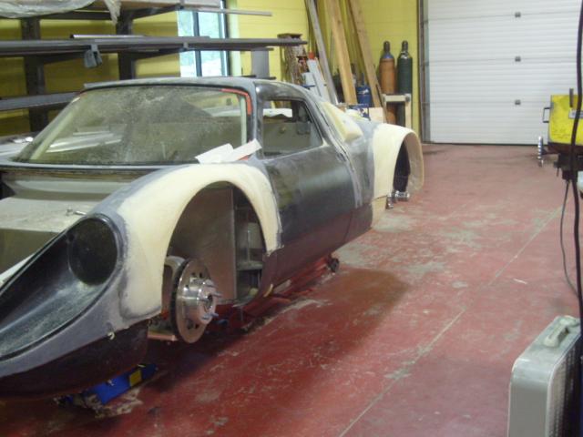

Pictures of the RCR904 with flared body in foam prior to fiberglass and body work...
There is also a ducktail on the car now ..but I need to take more pics

That flared body looks like it will be PERFECT! Keep the pic's coming.

A liquid cooled 6 banger sounds kinda heavy for such a light car.

Really!!.....dont think you will notice with 340 hp.....
