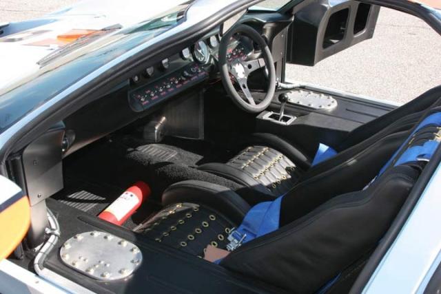

Mesa, you are correct. You have to look at this car at least somewhat as a test mule, though I think it is better off than that. For instance, the lift system on this SLC is not as nice as the later version that I have. But it works, and it works great. There are a few holes in the fiberglass that are clearly tests for parts that were later removed. These will obviously not be in delivered cars. The trim pieces in this car are not finished, such as the center console and the covers for the front roll hoop. My dad likes them like them, but I would not use them. If I were, I think they need to be nicely finished out in leather or ultrasuede. Even the center console - I may leave it off with exposed cables. The door hinges on this car are solid, but they do not hold themselves open, they have cotter pins you insert, and you can see irregularities where other hinge arrangements look like they have been tested. The cotter pins do not have the same feel as a door that opens and simply stays in place. I think this is or has been designed, I am honestly not sure. There is almost no insulation, so no wonder it gets hot. Does this mean it is a bad car? Of course not, if just means that if you don't put in any insulation it is going to get hot!
The hinge on the front clip is really sweet. The hinge on the rear clip needs to change some to let it be used with the wing in place.
Where the car is not so much a prototype is the drive. I just don't think anyone wil be dissatisfied with the handling. I think it is one of the easiest cars I have been in to drive HARD.
The windscreen is just cool.
When I look at this picture of a car I am pretty sure Fran did, it is a loooong way from the finish work on this SLC here, but is more in keeping what I think a well done car will be.
