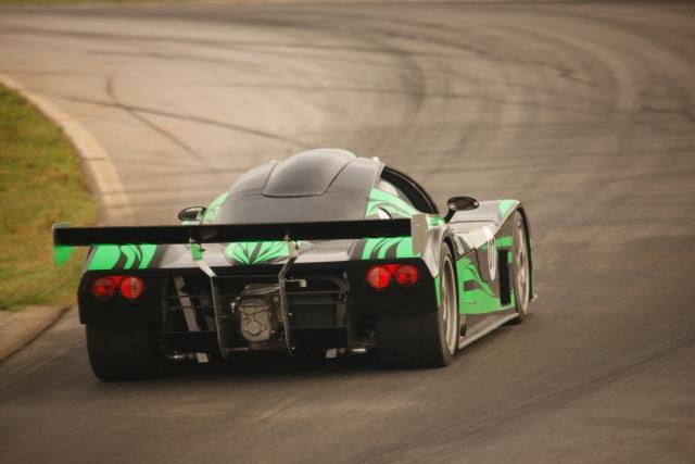

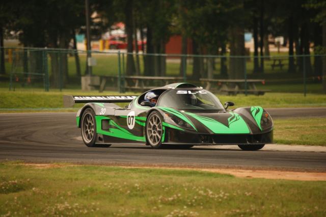

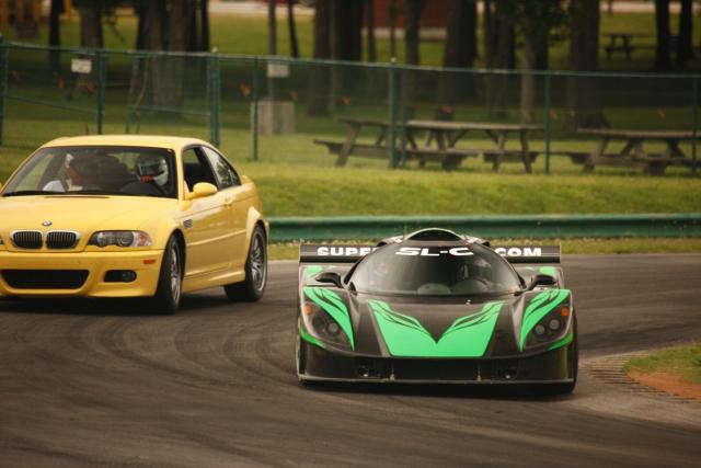

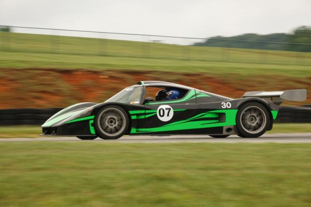

Continuing to shake out some little bugs. Found the clutch issue, which was a loose fitting under some heat shielding where you couldn't see the drip. Dad got a bit more track time, this time with Audi club. He spent the day under the watchful eye of Norbert Watts, who has spent a bit of time racing a T1 Corvette. Unfortunately, the fixed clutch meant that the car could be driven fairly hard, even with no digidash and no indication of revs. And this led to cracked front rotors. Fran is sending us new solid rotors. I am really liking this "drive it and have someone else replace parts" thing :)
I spoke with Norbert afterwards (I could not be down at the track that day). His quote was "it is very fast". Do you think it will be as fast as your T1? "Oh no, you don't understand. It is much, much faster than the T1 Corvette" Even driven with no gauges at a modest pace (Norbert said he was not about to push hard in someone else's car) it was the fastest thing at the track save for a Mercedes/McLaren SLR. And he thought with the rev counter, that would be no problem either.
With new rotors, we will be back at it on the 25th. We hope to have a new digidash mounted. I look forward to having my go in it!

Looks like Dad is about to fall out the window with the G's....may need to add a grab handle for him...
Gee....thanks....now about sending me that iconic old, slow, clapped out 355 as collateral....always wanted an Italian planter for the showroom....
Nice pics of the Coupe by the way.....can I get some more of those???

Nice track update and, as I suspected, glowing remarks about track handling and speed. Nice photos as well.
Keep 'em coming!

Nice pics and thanks for continuing to update the thread with your impressions.

Is it just me or does that M3 look like an SUV next to the SL-C?

Yep, an SUV for sure.....damn apartment building on wheels from the size difference!

Interesting on the whole drilled business, I don't think I've ever heard amongst friends having trouble with drilled discs on their bikes even on track days, I guess we have WAAAY less weight to slow down, even compared to the SL-C which, might I say looks FREAKING SWEET on the track but also FREAKING TINY next to the BMW....
