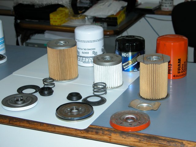

I suggest that anybody serious about their engine buy a few different filters then cut them open and inspect them. You don't need to be a technician to see how bad some filters are. While you're delving around inside, make sure you look at the bypass mechanism. Any bypassing filter will allow dirty oil through the engine but some actually wash the dirty side of the filter with the oil before letting it flow on through the engine... I kid you not.
If you get a non-bypassing filter just make sure it can flow enough oil for your engine and still filter it.
Filters sure ain't filters.
I won't name brands on a public forum but some of them should not be called filters at all, it's misleading.
Also, once you've looked inside it's surprising how "similar" some filters are to "other" brands. Perhaps "identical bar the paint job" might be a better description. In some cases it's a pretty expensive paint job as well.
See if you can find the brand with the "cardboard" internals.
Oh and be careful you don't cut yourself.
Tim.

I took a photo' today of three of the filters that remain from the pre mortem that we performed. Two have been mentioned here, the other is one I like.
I have a lot to say about one of them but I think I'd better not.
I have been using Hard Driver filters for a while now.
There are also a couple of "competition only" non bypass filters available that are of very high quality. Unfortunately I don't have photo's of them.
Tim.
