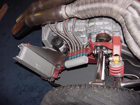

Here's a shot of Rick's G50 oiling/cooling setup. [img]/ubbthreads/images/graemlins/cool.gif[/img] [img]/ubbthreads/images/graemlins/cool.gif[/img] [img]/ubbthreads/images/graemlins/cool.gif[/img]

Rick, that is a really sweet setup you have there! They look like, what, -6 fittings? Aren't they kinda big for 0.050' orifices though? [img]/ubbthreads/images/graemlins/smile.gif[/img]
How did you arrive at that orifice diameter? I can't imagine you'd get very much flow out of five or six 0.050" orifices even at a fairly high pressure - is there another return to the tranny where most of the flow happens? What pressure does the system operate at? Do you have a thermostat in the line somewhere?
Sorry for all the questions, but I'm very interested in that setup.
