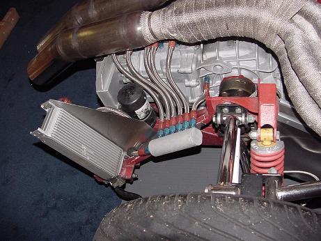

Sorry for the short reply but cant talk long. With the porsche flipping still keeps the box rotating the same way with respect to itself so not changes are necessary. With the ZF the ring gear must be flipped to the other side of the pinion to run inverted, but the box was designed symmetric for this option (or by accident). The Audi box is NOT symmetric and thus the ring gear can not be "easily" moved to the other side. I wondered if the case could be disassembled and machined such that another removable output shaft cover could be added to the other side making the case symmetric. Not sure it is worth the effort (machining, etc.) but I have thought about it.
In Ricks setup which seems great the filtered oil is returned through jets to each gear mesh and the R&P (six total returns).
Rick Merz
I use a Tilton pump but I will have to look up the model number and other information, if someone would like this info email me. It sprays all 5 gears plus the ring gear through .050 orifices screwed into the fittings, which are screwed into the case.
Here's a shot of Rick's G50 oiling/cooling setup. /ubbthreads/images/graemlins/cool.gif /ubbthreads/images/graemlins/cool.gif /ubbthreads/images/graemlins/cool.gif
Rick, that is a really sweet setup you have there! They look like, what, -6 fittings? Aren't they kinda big for 0.050' orifices though? /ubbthreads/images/graemlins/smile.gif
How did you arrive at that orifice diameter? I can't imagine you'd get very much flow out of five or six 0.050" orifices even at a fairly high pressure - is there another return to the tranny where most of the flow happens? What pressure does the system operate at? Do you have a thermostat in the line somewhere?
Sorry for all the questions, but I'm very interested in that setup.
I'm definitely adapting that to my box, at least one spray over the top into the R&P. The others would be a little more difficult onthe Audi box but certainly possible.
