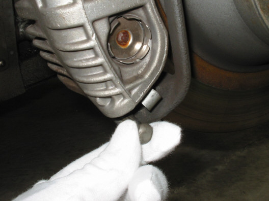

All comes back to me now. Here is the method for future reference.
Remove circlip and washer from the lower retaining pin, then withdraw pin.

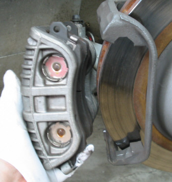

Pivot the bottom of the caliper away from the disc.

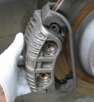

Withdraw the caliper totaly for access to the pads from the inside.
