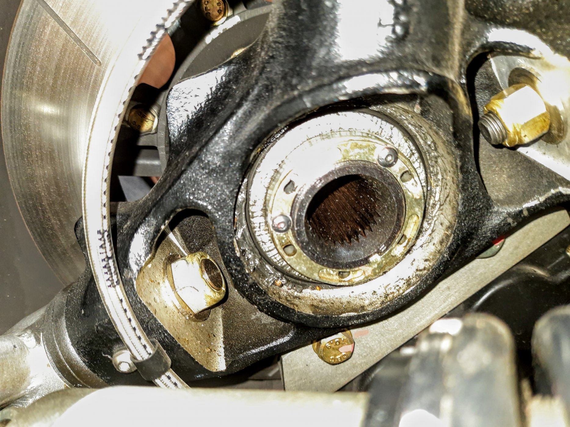

However recently after i heard the rotational knock i went to check the wheels and felt no play in either of them. However when i rotated the wheel clockwise and anticlockwise quickly i could hear a faint knock sound. On inspection of the bearings i could see grease has begun escaping from the bearing.
As you can see from the picture the grease is gathered in the 9 o clock position. The other front bearing also has grease coming out of it.

1, Does the leaking grease confirm the seal is destroyed and internal damage likely ?

I would replace the bearing with a similar unit first.
If the problem occurs again, then its time to investigate, otherwise it might just have been bad luck.
That bearing has a runner and a race, both have numbers stamped on them which makes it very easy to replace them, and even for a Timken or SKF unit.
No need to get them from SPF.

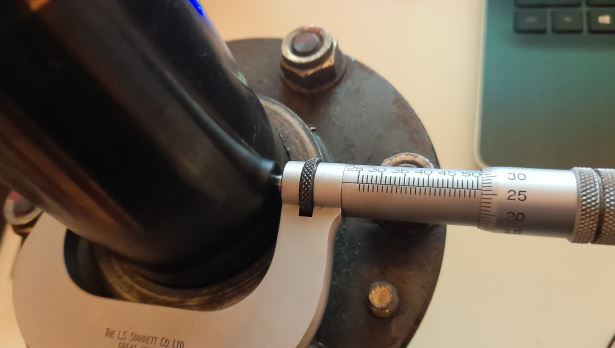

Once you have removed the bearings I would recommend measuring the bearing locations on the axle. The ones I have are 50.76mm and they should be a minimum of 50.80 so about 0.040mm too small, and the bearings are loose, so they need some form of repair before thy can be used.
Once you have removed the bearings I would recommend measuring the bearing locations on the axle. The ones I have are 50.76mm and they should be a minimum of 50.80 so about 0.040mm too small, and the bearings are loose, so they need some form of repair before thy can be used. View attachment 115020
Thanks Brian, where did you get the 50.8 dimension, is there a drawing of the axle tolerances somewhere ?
Hi Jason, I am not sure what the exact dimension should be, but the bearing is 50.8 and it needs to be a light push fit onto the axle so there is no play or fretting, so if you machine to exactly 50,8 you wont be far off.
