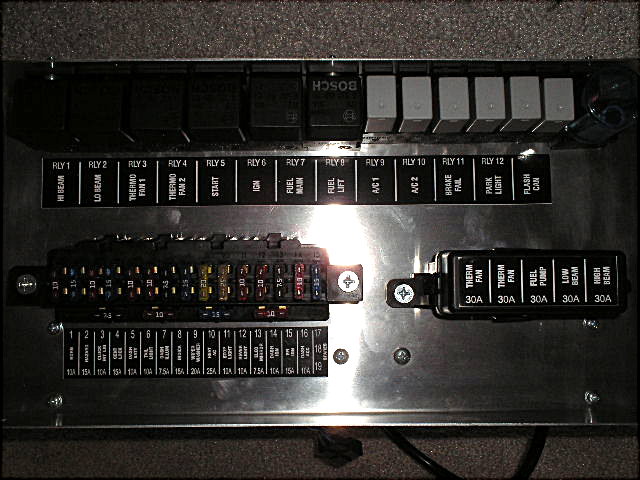

Anyone know what relays go with what circuits? The blade fuses are labeled, but not the relays; nor can I find a 'map' of the relays in the electrical manual. I can't seem to get my radiator fans nor the speedo/tach to work, thinking electrical. Any help would be great.

Here ya go Pat, hope this helps. The picture is not the greatest , let me know if you cant read the label. What did you end up doing with your engine stabilizer ? I don't think mine would fit with the RF crossover exhaust.
Oh . Pat, if you did not notice the sticker does not line up with the relays the way RF placed , spaced it. You have to count them from one end.

Gracias Dan, exactly what I was looking for! I pulled the relays and jumped the circuits, fans work, so I'm scratching my head.

Sounds like its not getting the signal from your ecu (which I guess provides a ground to activate the relay ) ?? Your temp is set right in your software on your motec , right ? I am running a Haltec , but am wiring it up still.
