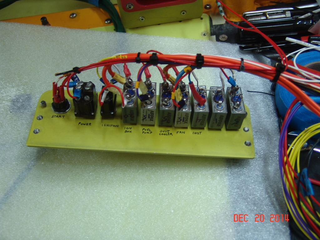

"My, but it's a tight squeeze working on the wiring under the dash!"
That's why I made my switch/circuit breaker panel removable. The "XXX" breakers are for future use.

Bob, your wiring diagram - most impressive, thanks so much for pasing it on. It is the first time I have seen a diagram incoporating the a/c. Nice to see how the Indak switch connects. I absolutely take your point about the Lucas switch. I recalll the comment by Bud Jones that he took steps to stop the ignition switch overheating. I wonder why this was happening with his car? I can see that diagram of yours is going to give me many happy hours of contemplation!

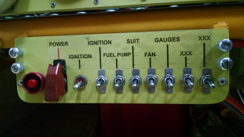

Yes, I can see how the existing system drove you to such a radical solution. That must represent a considerable amount of time. Well done!
