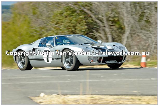

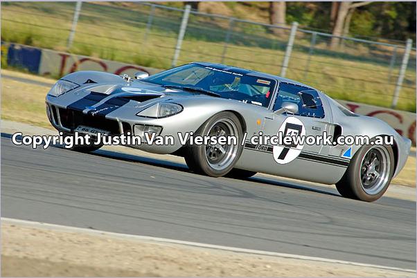

Ross,
Have been thinking more and more about how I am driving the car and if the understeer issue is driver error.
To some degree you are probably right. I have been taking a lot of notice of the fast guys and have invested in some 1 to 1 in car instruction from a few as well (the instruction is probably more valuable than making mods to the car in some cases) so I am reasonably ok with the lines being used. This is not to say it's not driver induced.
There are two particular corners where the problem is greatest.
The first is a long 170 deg right (Cat corner) at the end of a 180ish km/h (for me) straight which has a real late entry, I then place myself about mid track 1/2 way round, then apex about 3/4 the way around. I am very concious of staying wide and not turning in too soon on this corner.
The other is a 160 deg uphill corner (Shell) with similar positioning and apex points. This corner sucks you in to putting down lots of power and is after a series of high speed, 4th gear, esses.
In both cases turn in is sharp and direct. The push starts from about mid corner during the transition from trail braking to throttle and increases as throttle is being squeezed on.
I have tried a big stab on the throttle a couple of times (to see what will happen) and resulted in immediate oversteer which was not unexpected, but, quite sudden. Needless to say I have not been tempted to try that very often.
I have the final sprint for the year next weekend and will do some more evaluation of my technique and will endeavor to get more camber in the front end by then with luck. If I can't get the work done to the front I will try for a few tuning days early next year.
Two photo's are attached showing the limit of body roll. One from a hill climb right on the apex and another just after the apex on the circuit.
Appreciate your inputs.

Rick
These corners are really fast sweeping bends. My guess is the g forces have overcome your tyre grip and the car is not balanced so the front has let go before the rear. By applying power you have provoked oversteer because the rears have run out of grip too and the sudden driving force from you stabbing the throttle, tips the rears over the edge. More camber, balanced suspension and softer tyres will improve your corner speed and stability out of sight. With the balance right the G forces should make the car drift wide away from the apex in a controlled 4 wheel drift. This is assuming you stay on the throttle through the bend. Of course the trick is to know when you've reached the maximum speed your tyre grip will allow. As the books say many drivers are intimidated by these fast flowing corners.
Good luck at the sprint next week.
