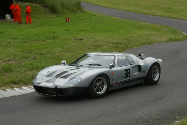

The Avon CRZs are fine for road use. In the GTD40 car club, a lot of us (including me) use them for racing in the wet as well as for general road use. I have driven on them from England to the Le Mans Classic and back 3 times now and had no problems at all. They also look right on the car. The first photo below is a picture of me racing at Gurston Down hillclimb on the Avons.
In fact I even use them on hillclimbs in the dry as I find the Blue Streaks pretty treacherous unless they are used on a circuit - in which case they are great.
I think the video referred to above is of me on the Blue Streaks racing at Lhergy Frissell (the longest hillclimb in the UK). The car was tramlining on the Blue Streaks as I approached the first corner and then skipped offline just before the braking point, forcing me to straighten up first before braking (and after I had missed the braking point of course). Fortunately I made it round the hairpin still but I changed the tyres over for the Avons on the next run and was 5 seconds quicker.

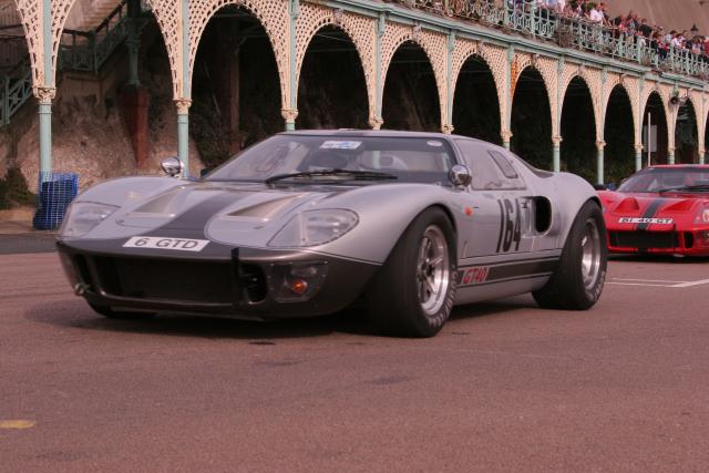

The second photo shows what the car looks like on the Blue Streaks (this time I was racing at the Brighton Speed Trials). The third photo shows the "tread" on the Blue Streaks....as you will see, they are effectively a slick even though they have some tread on them.
One final point is that the Blue Streaks are not legal for road use in the UK and I would be very surprised if they were in the US.
