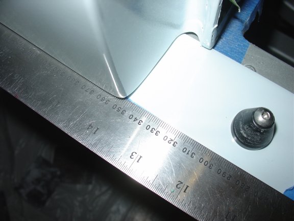

Jim Dewar
Hi Pat,
I think you could read this in the manual either way unless you've been there. I hoped Robert might come back and confirm. I believe yours is correct.
Thanks,Jim
