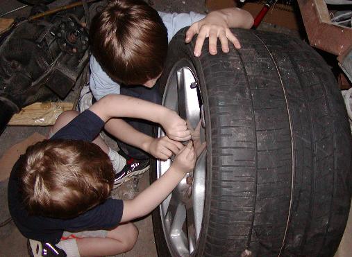

Paul,
Those are pretty reasonable prices for new Vintage Wheels. Quite a good selection also. Mine is a daily driver, so i went with 295/35/18 on the rear and 255/45/17 on the front. Nothing fancy, but it gets the job done.
