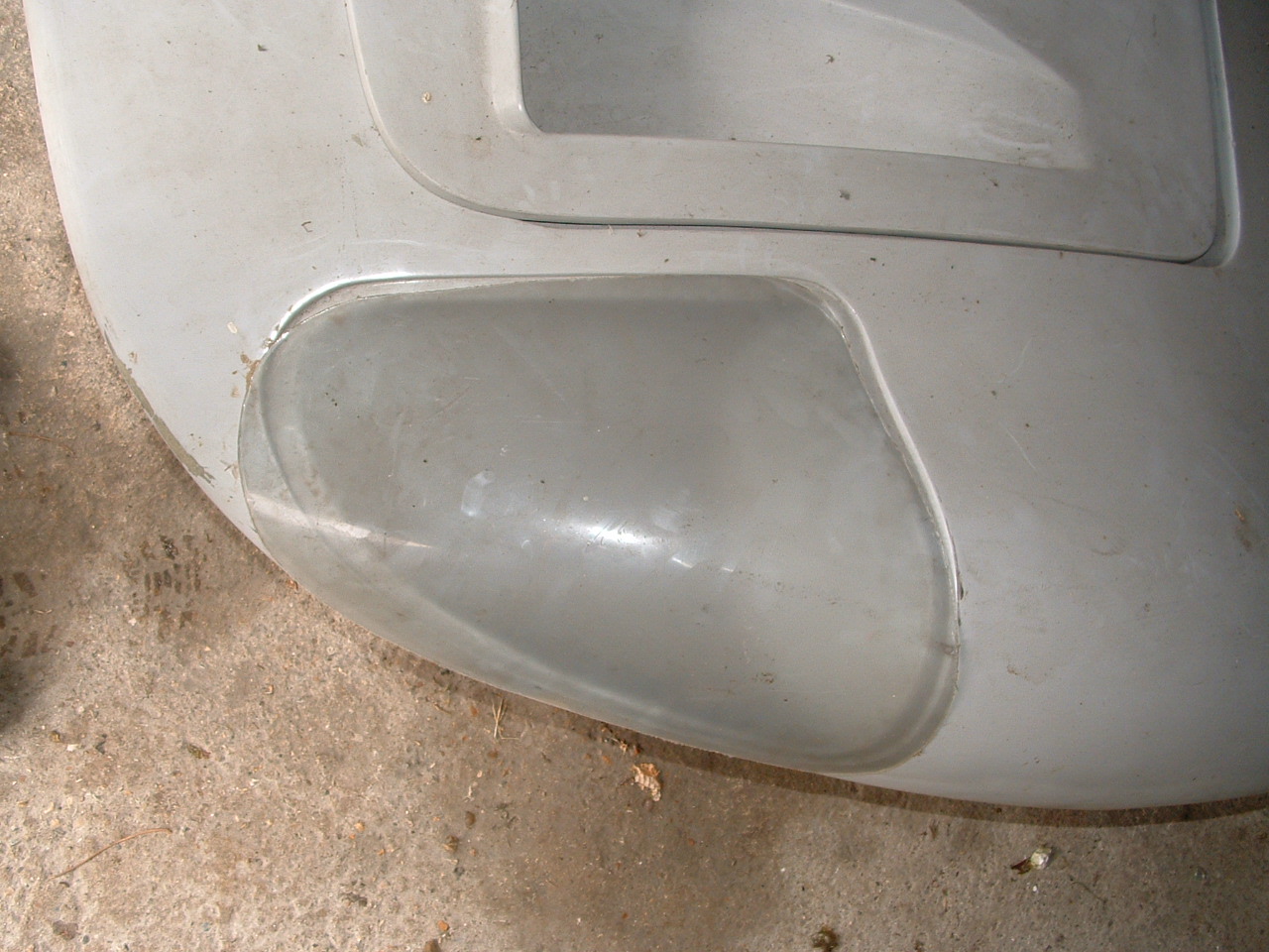

Completely new to this, I have a barn find of a GT40 replica. It includes a square box section chassis frame and all fibre glass panels, but nothing else. It has been abandoned in my friend’s farm barn for the last ten years and he has given it to me as a gift as he needs the space. I also have a friend who has offered me a Ford 6 litre V8 and a Porsche 6 speed transaxle gearbox (not free) to get me started. My first problem is I would like to figure out who would have made the original kit? I have done a little research so far and it is done in the style of the road going version, I know this as the main headlight shape is different from the racing version. I will post some pictures once I have shipped it to my house. Does anyone think I might have bitten off more than I can chew taking this on?

Only you can determine your capability. Don't let others discourage you! My psychic prediction is that it is a KVA MK III kit. The 6 speed may be a bit long if it is. Congratulations! The only thing better than a GT40 is a FREE GT40!

If it is a MK III then fitting a longer trans is no problem as the MK III's were longer in the rear section to accommondate luggage compartments. Also it was the only GT with round twin headlights.

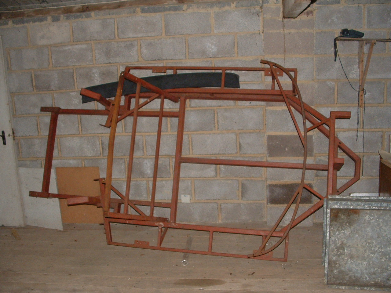

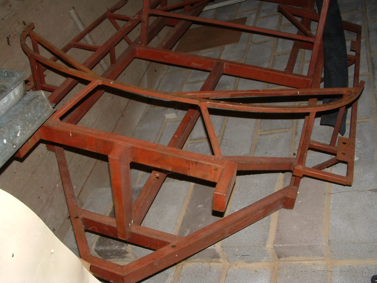

Oops....with the picture attached this time!

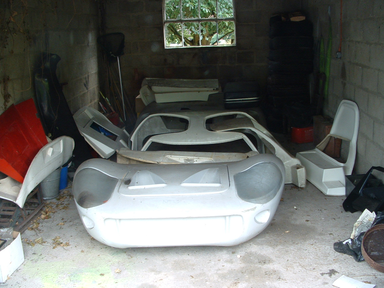

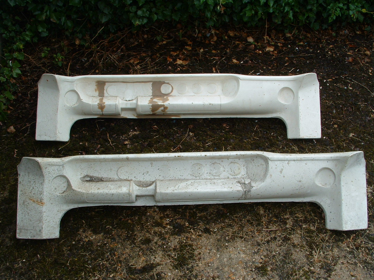

I picked up all the smaller fibre glass parts today and brought those home. I have three set of dashes, one right hooker the other two left. There are also two extra inner door skins, but I can't see any sign of the sills! If you have any idea what I have got here let me know please! Also one of the dashes seems to have been made shorter in overall length for some reason???
KVA MK 111. Early chassis.
A great gift but a lot of work for you if you have limited experience.
Good luck....
Graham @ GTA.
What chance does anyone think I have of getting the missing parts, maybe from a different manufacturer even?

KVA only supplied the bodywork and chassis. All the other parts were sourced from several diffent vechicles from the 1980's.

There are no supply problems for any parts to complete this "project" but your biggest headache will be with the front and rear suspension. As i said in my earlier reply, this is an early chassis, and should have been humanely put down by the vet !!!!
Basically you will need to cut the front and rear off and replace with a proper wishboned and coilover set up. Not difficult but messy and costly. My advice would be to forget about that chassis and buy a replacement unless of course you are an engineer and want hassle.......
