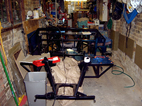

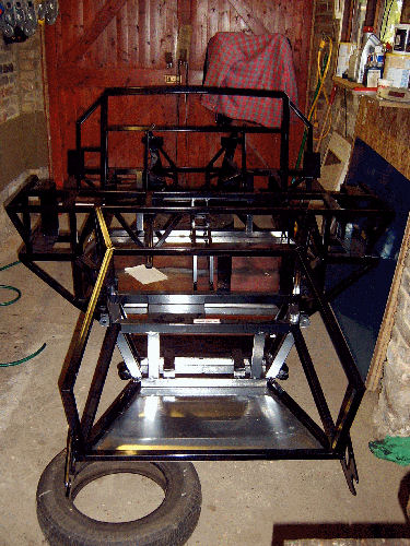

Well it's about time i started this or it will never will (the thread not the car).
The rolling chassis kit was collected about 6 weeks ago, so far cleaned the garage, sorted my tools, bought a new aluminum jigsaw blade and started the build.
I Hope it will take quite some time to complete, the enjoyment is in the making and the odd hour 'tinkering' in the evening whilst the soaps are on the TV.
Also it may take a while longer than some others as i only have a single garage, although so far I have only found that this means I have to organise myself in advance and be tidy
A picture showing the acres!! of space i have to work in. Just realised teh title of teh tread doesn't make sense unless you know the first 40s were built in Slough.

Gibbo
Congradulations on getting the car ,Hope you have lots of fun putting it together.
You do look a bit confined for space.
Do yourself a favour & make some sort of stand with wheels.
The car will get heavier as you go.At least you can move it from one side of the shed to the other.
Have fun Jim.
Already done. An unwanted length of kitchen counter about 3 foot long, for casters and 3 old tyres. Once teh wheels and susspension are on i wil make up some wheel dollies to move her around

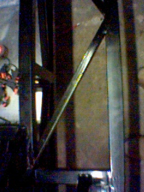

A little progress. I have welded in the sill top strengtheners, now the sill tops don't bend when you sit on then for a contemplative cuppa!!!
This weekend will be rear bulk installation and maybe some front bulk head work.
Also i will be ordering at least one Tornado seat and runners so I can position the cross struts for the runners. thanks for the measurments Paul, but i don't feel lucky. Its not like it will be a waste of money, i need a set of seats.
