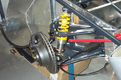

Hi Geoff,
This is the photo I recalled seeing, which didn't leave me with any concerns. Granted I can't see all of it, but the spindle, a-arms etc. look as good as what I have on my track car. I am missing something?
Al H
