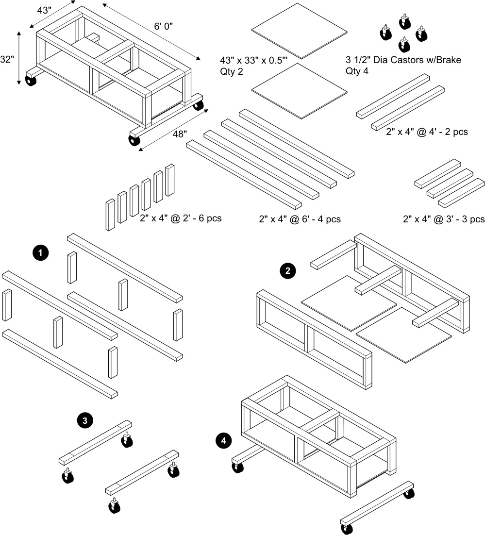

Hey guys - haven't built it yet but thought it would inspire anyone else looking to build a cart. I wanted to eliminate wasted materials and make it as easy as possible to build by using 6 and 8ft 2 x 4's and 3-4 inch castors.
Thought the shelves would come in handy-

Chris, I would maybe think about a little more support on the sides in the form of a flat piece from front to rear sticking up 8 Inch or so - to make the whole thing from trying to fold flat. When I had my car on it's stand ,(Sounds like a war story on it's way) I found that 20 inches from the car floor to the concrete was high enough for me - also meant I could sit down. Mine was alot simpler in that the base was only about 8 inches high with 4 axle stands fixed to it. I then had a piece of 2 x 2 running from side to side with foam for the car to sit on which protected the cars floor. It wasn't very pretty but it appears in my early build pics.
[/ QUOTE ]
Or triangulate. Cut a bunch of triangles out of plywood and put them in various corners.
I agree with both the above.If you don't triangulate both lateral and forward, it could colapse on you. Not too bad if you have tires mounted but terrible if you don't. I would also beef up the corners. 2x4s tend to warp or twist over time as they dry out. Also, notch the top rails into the post and use long deck screws or carrige bolts to hold.
Thanks for the input guys, should be a decent dolly once all of the suggestions are incorporated - and I'll have some extra firewood when I'm done.
