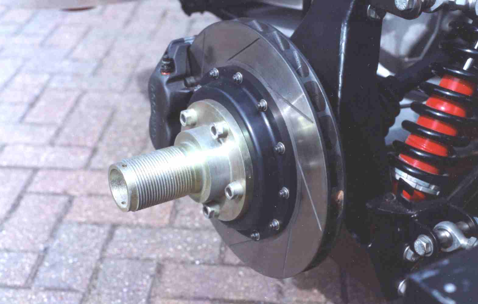

I have 5 bolt Granada hubs on my car with 5 pin adaptors. they use special nuts that hold the adaptor on as drive pins for the wheel. These were made by Ken Saunders some years ago and are no longer available. If enough people were interested, I may consider having some made. The problem is they may vary depending on the wheels you are using.
Brian.

Many thanks, your comments confirm what i understood to be the case.
