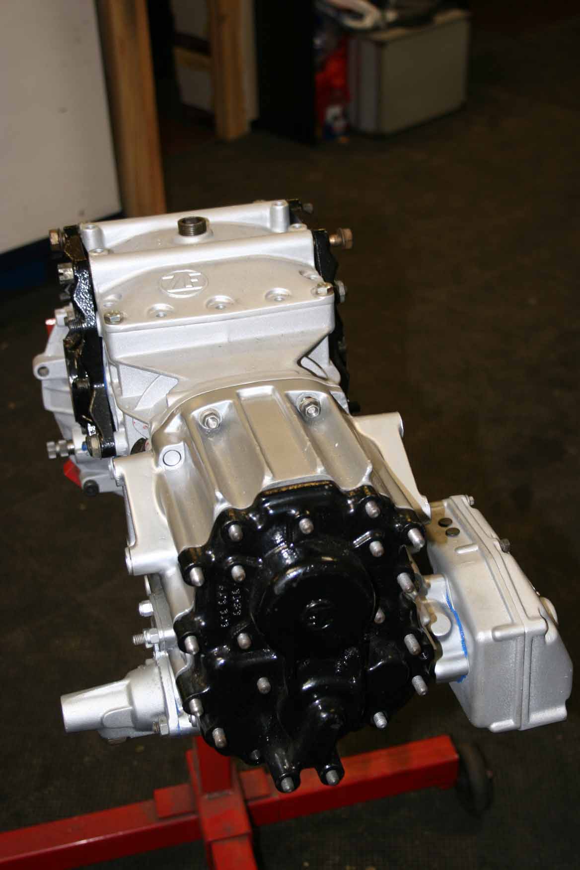

I've had a couple of gearboxes cleaned up now. They were taken to Chingford Metal Finishers (CMF) in Slough (Ajax Avenue) and they used glass bead which brought the finish up to a remarkable 'gleam'. The inside of the boxes was untouched, all bearing surfaces were masked, and all oilways plugged before they went into the cabinets. Then they were thoroughly washed (truck cleaner followed by hot pressure wash ) and then sent to Nicholson McLaren (engine builders) who then washed them again and then painted and baked the outside. All of the castings that were painted black by ZF also went to CMF and were similarly bead blast but painted gloss black at CMF. These were ZF 5ds25's that Fran Hall sourced for me. One will be fitted into my GTD with all the other bits in the near future by Hugh Absolem. Hugh makes control cables for just about anything and all my GTD cables came from him.
I dont see any problems at all if everything is thouroughly washed and cleaned prior to re assembly.
