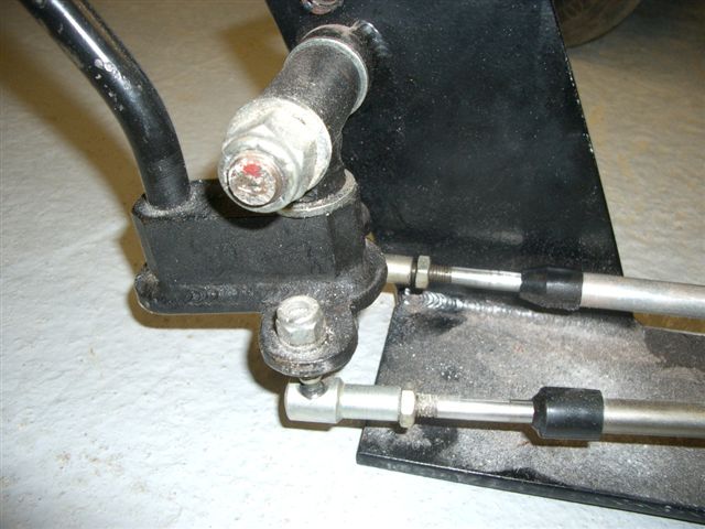

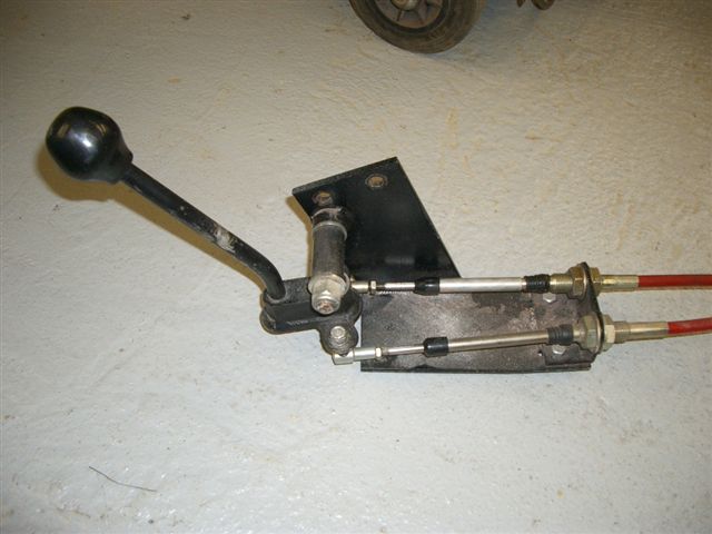

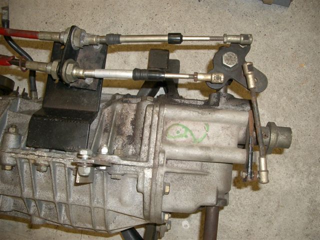

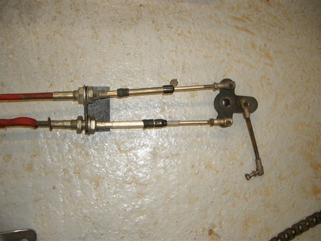

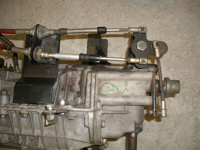

Here are some pictures of a standard GTD cable change. You sometimes see these advertised for sale in the club mags, or you may be able to fabricate something similar.
I'm sure you can 'suss' how it works from the pictures, Hope these help!!

If you are going cables, then seriously consider using a rose joints and not the knuckle joints as in Julian's pictures. The knuckles suffer and put play into the system after a while. A well set up cable system can work very well. It just takes time to align it all up correctly.
Once again you have given me the information I need. Julian, Sibbat2 and Malcolm thank you all very much. The pictures are just what I was after Julian and I think I have a much better idea of what is required. I have some rose joints spare Malcolm so I will base the set up around them. I have just been down the local marine chandlers and obtained the two cables. Nice and heavy duty so they should do the job ok.

To express an opinion, I offer that the GTD cable mechanism design holds a distinct advantage that many others do not. With this system, both selector and gate articulation loads are spread across both cables, as each function employs both cables simultaneously. This allows for reduced cable sizing, and eases routing issues. When comparing this to a typical cable system that employs one cable for each function, the latter requires significantly larger and more robust cables. The larger cables are less flexlible and of course larger in diameter. The only down side I can think of would be the additional friction created by activating two cables simultaneously, but that might be offset by the smaller cable size. Still, I think the GTD is a very clever design. That said, is there a GTD owner that is unhappy with this system? Perhaps it harbors some flaws?

Malcolms comment above is most important. Change the knuckle joints for rose joints. While testing, before the car was on the road, at least two of the knuckle joints broke. They have a weak point where the thread joins the ball.

Simon. One other thing I have just remembered. The large black fabricated bracket which bolts to the gearbox, you can see on the gearbox photo's above. Check the welding on this. On mine, although it was finally painted as a finished item, one of the fabricated welds had only been tack welded. As a result, it broke after a few hundred miles on the road. Fortunately, I wasn't too far from home and after manually selecting third gear at the gearbox end I was able to get back

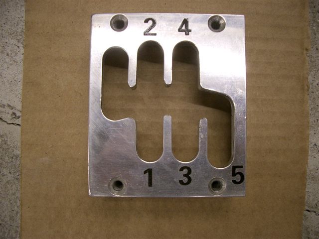

Before we all get carried away by the merits of the GTD cable gearchange, may I explain why I scrapped mine.
The simple reason, and I'm surprised no-one has mentioned this yet, is that the gate is reversed. When I started driving my car, the previous owner had stuck little numbers on the gate to remind himself which was which, and I never got over having to look down to check. Taking a quick downchange from 5th to 2nd at 80-something on a quick approach to a roundabout (in a land far, far away) doesn't bear thinking about! So, at the end of the first season, out it came.

I did notice the gate being reversed. It would seem that there are a number of ways to fix that with the same basic design. For example you could connect the cables above the pivot point on the stick rather than below it. Another would be to connect the cables in front instead of behind the stick. Obviously these would all require fabrication.
