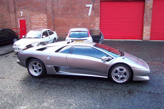

From your online name I assume you are an owner / fan of the famous italian sportscars. I was fortunate enough to own a Diablo SV and untill last year a Roadster. Great cars, very fast but the service costs were as large as its rear end!.

Very Nice car simon, I'm building a local kit of a Countach, finances don't stretch to a real one, unless wife can be convinced to sell the house and maybe the children lol .I am using a Lexus V8 and Audi 016 Quattro,using 4wd as you are a Lambo owner these may be of interest most of the guys on these sites own REAL lambos http://www.lambopower.com/forum/

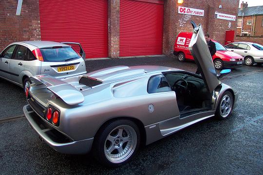

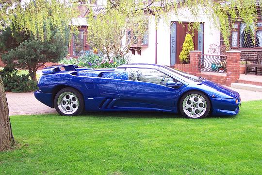

Thanks for the links, I will check them out later. All Lamborghini's are fantastic cars in my view, be they real or recreations. The Countach is also one of my many favourite cars. Totally in your face with an exhaust note to die for. The first Diablo I had was a limited edition titanium silver SV. It was one of the last made with pop up headlights and had the 530 BHP engine set up. Being a 2 wheel drive with all that power on tap it was rather scary at times. The Roaster was a bit more civilised to use but still had quite stupid performance.
