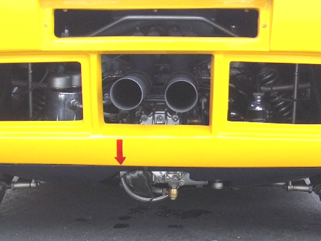

Here is a picture of the back of car GT40P-1077. The bottom oil hose for the ZF is at the bottom center and does looks low. I don't know if it is really as low as it looks or if chassis and suspension components are really closer to the gournd.

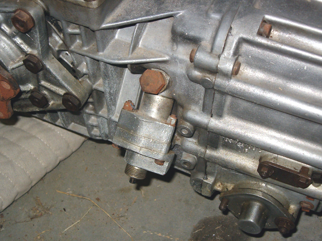

Here's a photo of the oil pump on an early ZF 5DS25. The discharge and return are on the underside, and the square tang visible on the end is the speedometer take-off.

these speedo drive oil pump are not cheap unfortunately (I was quoted $1200+).
Paul (ZF exert here in UK) told me the top cover is drilled for one oil pipe (the return I guess). I can't recall where the other came from, but have a feeling its the rear cover.

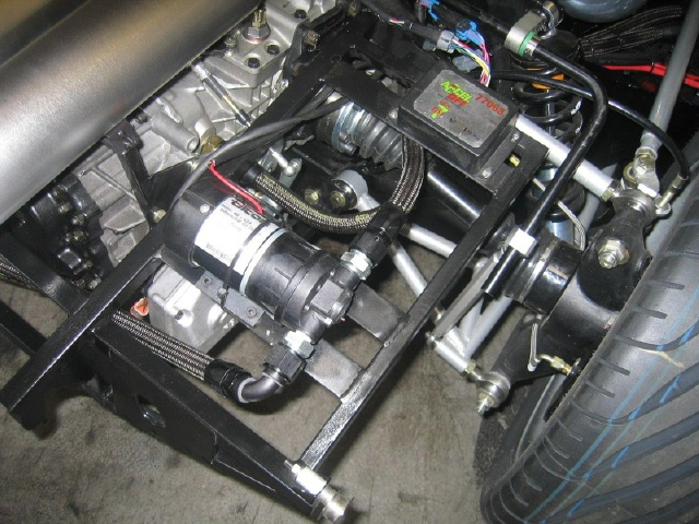

I didn't want to fake it on mine. I had R.E.D. provide a differential pump, and it is installed very similar to the photo in the earlier post. I'll try to post photos with this response, but if it doesn't work, just PM me, and I'll forward the photos to you.
Miles

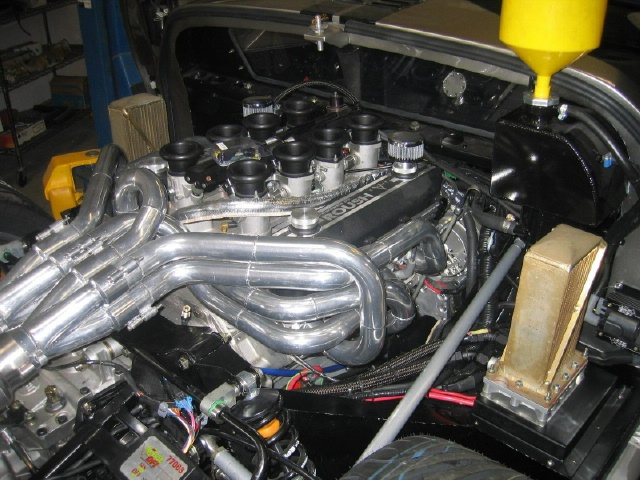

Miles
Where did you get those neat old oil/air heat exchangers ? I have a few like that and you don't see them that often, but when you do they always seem to be painted gold.
Those are the coolers that come standard with an SPF GT40. At least the one on the left side is. The trans cooler on the right is a $1500 option.
