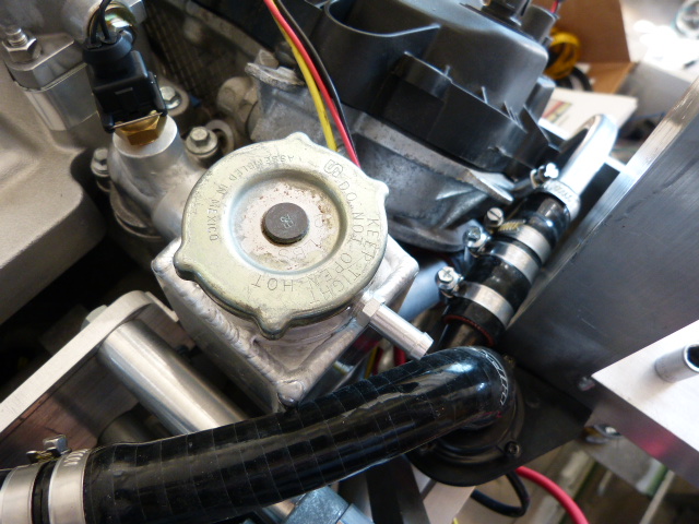

The coolant sensor for the electric water pump is installed in the coolant neck on the outflow from Coyote engine:
I was told by the Davies Craig folks that their EWP controller pulses the EWP on cold startups such that the warming coolant is cycled out of the block and thus to where the sensor is located. I don't have first hand experience with this yet (still working to get to initial startup) but in theory it should avoid the situation you've described.
That should work. Even without the EWP pulsing, just the tiniest bit of bubbling should create enough movement to get hot water to the sensor. Especially without a thermostat blocking the path. Some old tractors relied on the percolation rather than a water pump.
