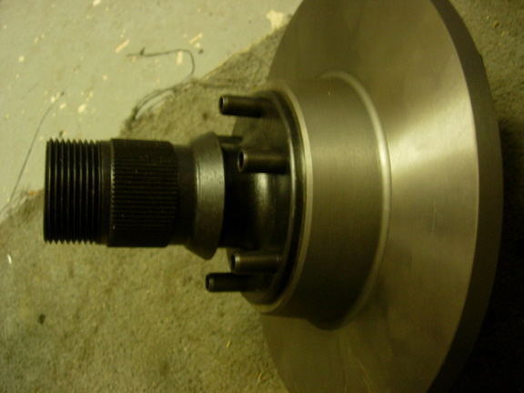

Front hub from my car

Thanks for the picture Chris! Here come the questions. Will a pin drive BRM wheel clear the slines and borrani rear locating register and still locate itself with the three eared knock off or is this a pin drive hub thats been modified by grafting a splined hub to a pin drive hub for a borrani only??? What is it and where can I get a set? Thanks, Rick..........Incidently there was just enough meat in your valve covers to machine them to fit probe shaft rockers on AFR heads. (.080 left ) It's enough.........Rick
Hi Rick
The hub in the picture is an original GT40 hub without modification, the BRM original wheels fit straight on and clear the spline and the register. I think original hubs maybe hard to find, I may be able to help but will have to check some dimensions first.
