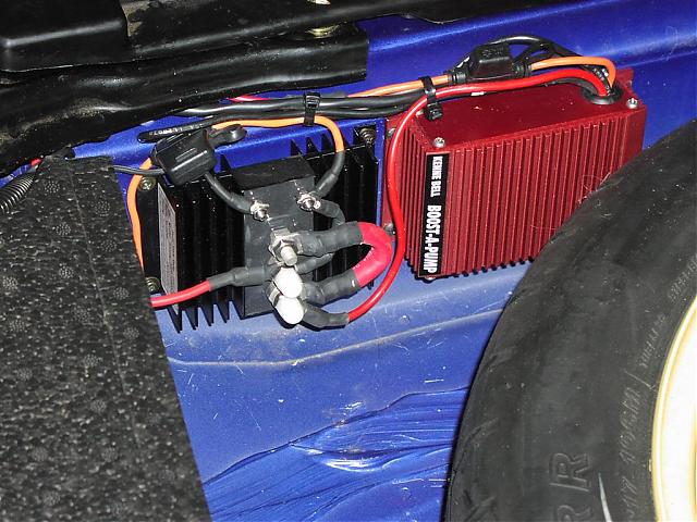

Completely agree on the solid state relay, however these things require judicious heat sinking & mounting to optimise their performance don't they. I'd used them years ago with mixed results, as I failed to follow their advise on heat sinking, and smoked one.
I'm now using an SSR in my fuel pump circuit, along with a Kenne Bell BAP and PWM control from my ECU to vary the voltage to my fuel pump from 8.5v at idle to 16.5v for heavy boost. Works a treat and minimises the amount of hot recirculated fuel to the tank. I plan to convert my radiator fan circuit to a strategy like this.
These guys: Solid State Relay (SSR) for Switching of DC currents or loads up to 300 amps IMO, are the last word in "packaged" SSR's. Their relays "start" at 50 amps and go up to 250 amps. Then, if you need to switch more than that, you can parallel them. :)
