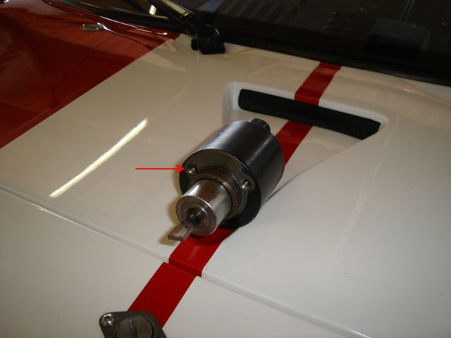

I had his problem recently on my CAV solenoid and it turned out to be internal corrosion on the terminals. I removed it and sprayed WD40 in through the starter to solenoid screw holes and after a few clicks it came right and has been ok since. The securing screws have sealant on the taper which wears off allowing moisture to seep in.
