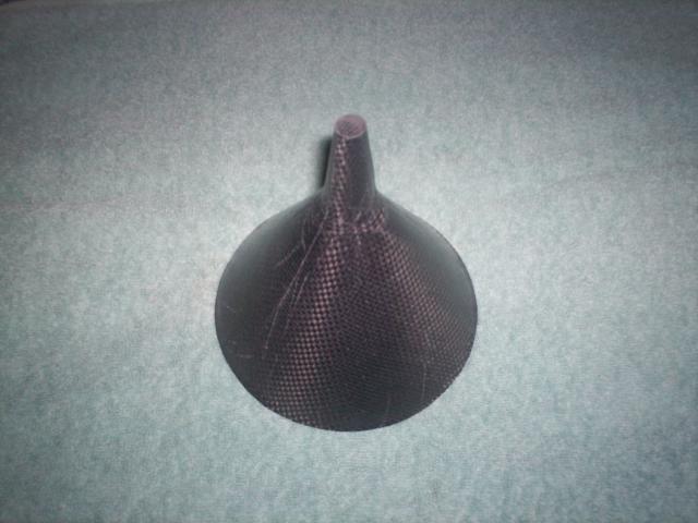

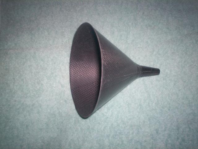

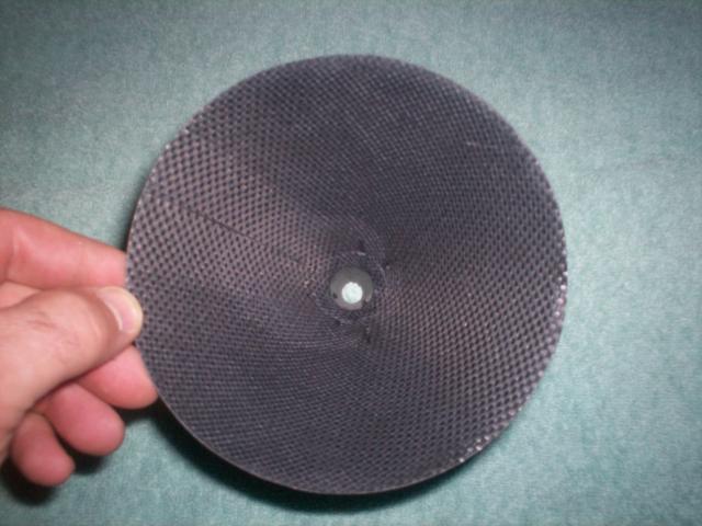

I had to ship my shop projects home as I did not want to carry them on the airliner home. I'll post some pics when they arrive. One was a really cool funnel I made out of 3 ply's of pre-preg plain weave aerospace grade C/F, vacuum bagged and cooked off in @250F composite oven.
Its so strong you could probably park a tank on it!

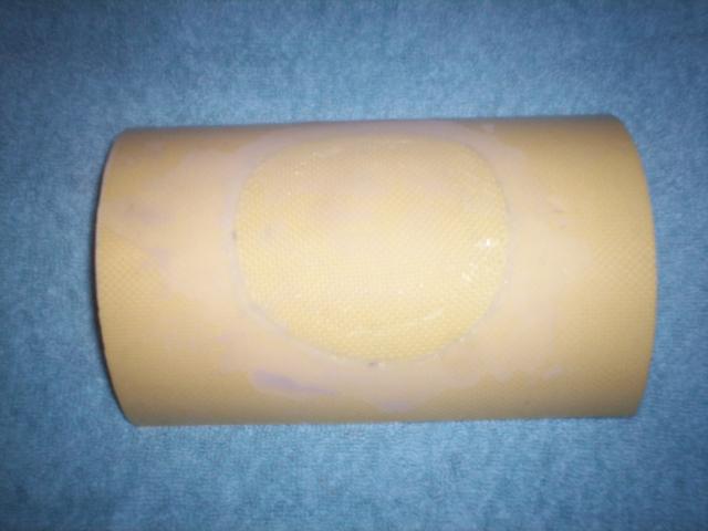

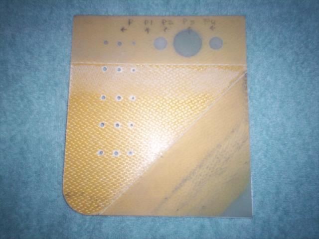

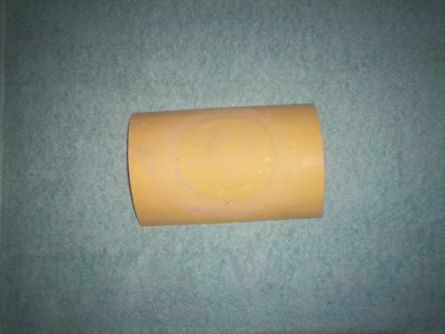

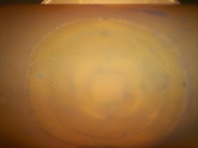

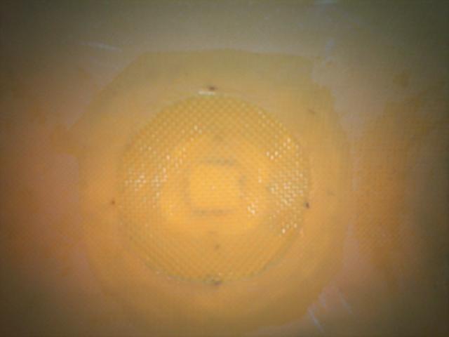

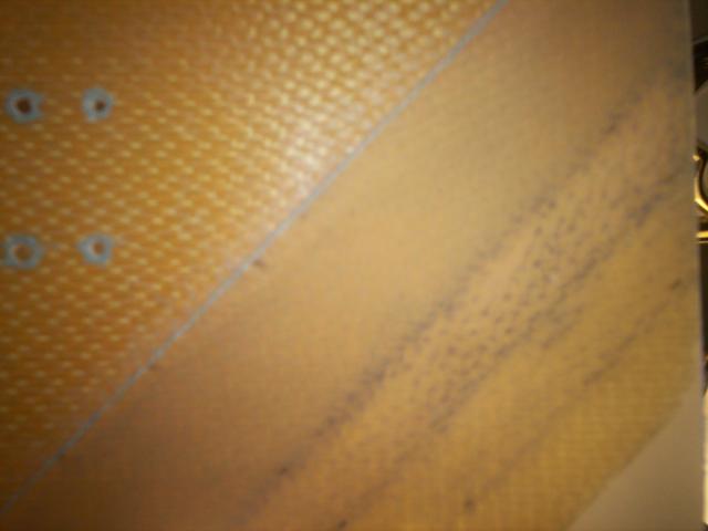

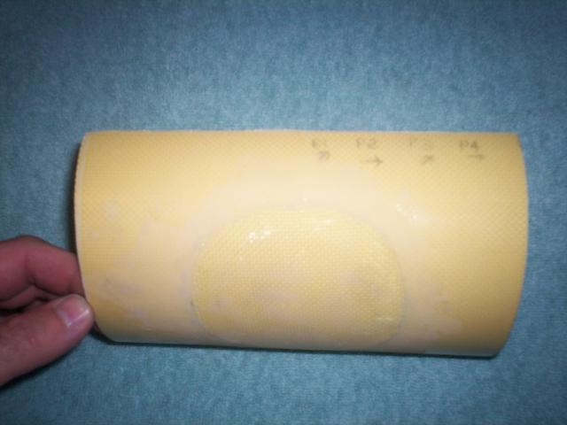

Some composite repair course project pictures....
1st repair is to a "Mock leading edge" I built up out of 4 ply's of pre preg harness weave Kevlar 49.
A hole was knocked into it with a hammer to create the damage.
Then the damage was cut out with a carbide router bit and step sanded back through the 4 plys of kevlar (aramid) at 1/2 in spacing.
A back ply and then the 4 repair plys were installed using a wet lay up matching the oringinal ply directions to return the piece to original strength.
You can see the separate ply's in the pictures.

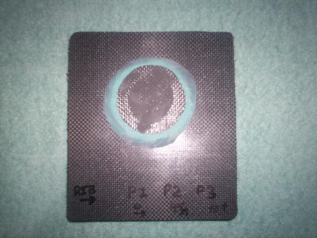

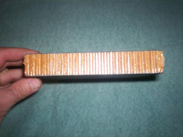

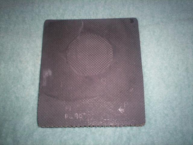

The next two repairs are on a 1 inch thick piece of honeycomb core carbon fiber sandwich panel, 3 ply's each side of 3K plain weave pre preg carbon fiber are used in its construction.
The two hole repairs shown were done with;
1) Removing the damaged carbon ply's and honeycomb core on one side and reinstalling new core material, then ply's.
2) The other repair on the side without the blue film adhesive, was done by replacing the core material with syntactic foam.
Both were step sanded back 1/2 inch on the three ply's.
The last two pictures are of some repairs to a flat sheet of 4 ply Kevlar 49 sheet showing drilled hole fills using milled fibers and a corner repair using plain weave "S" glass cloth.
Then of course is the worlds most expensive funnel!
I am continually amazed at the lightness and strength of these materials.
The 6x8 sandwich piece shown only weighs an ounce or two, yet is unbelieveably strong in torsion, compression, and bending.

Just weighed the 6x8x1 section of C/F sandwich pictured above, (the piece with the two core repairs in it).
It weighs just 4.2 oz (1/4 lb) or .1191 kg.
