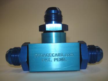

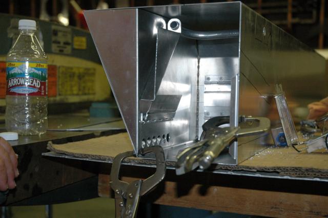

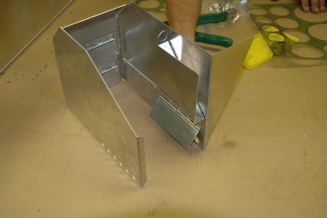

Recently fabricated new tanks for my Tornado with built-in swirl tank. Both tanks have there own external pump, filters, regulator and return line. I installed a unique, yet simple, tee 'fuel valve' that works great for switching from one tank to the other. Link and pics below (check out the fuel schematic as well).

Note: currently I am having issues with my breather tube whereby the rollover valve is not sealing fuel that may want to push up the tube during hard braking. In my opinion the rollover valve is not sensitive enough to seal.
