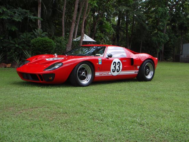

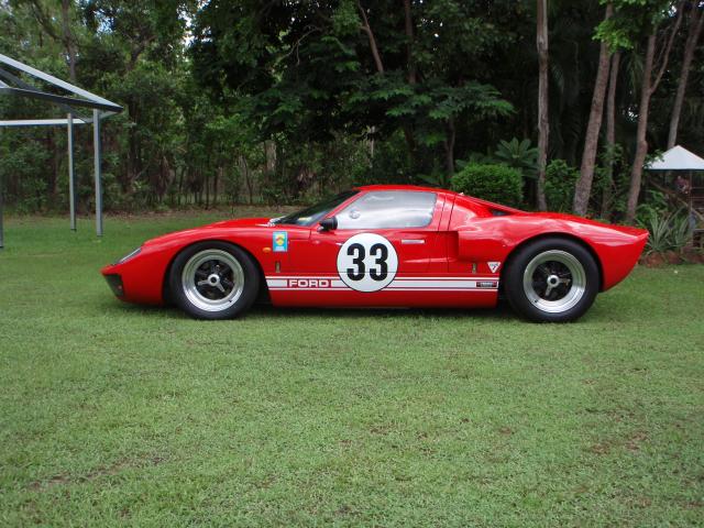

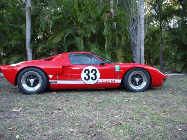

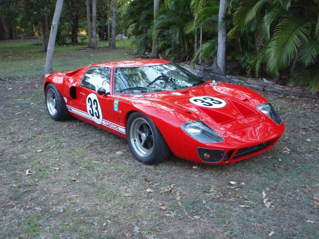

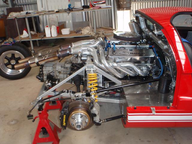

Hi guys, this is my first attempt at posting. Here are some pictures of my RF which is now registered. Thought I'd share them with you.
Regards Udo from Darwin.

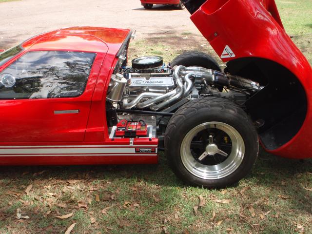

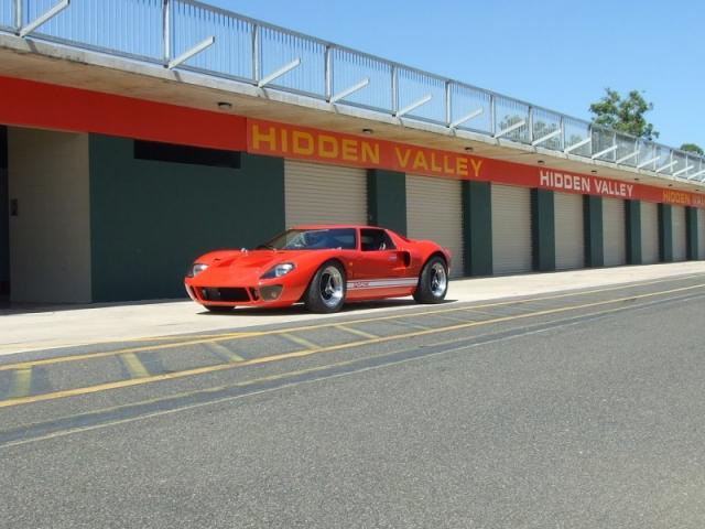

Hi Udo
Great to see you have made the plunge into the digital world :laugh:.

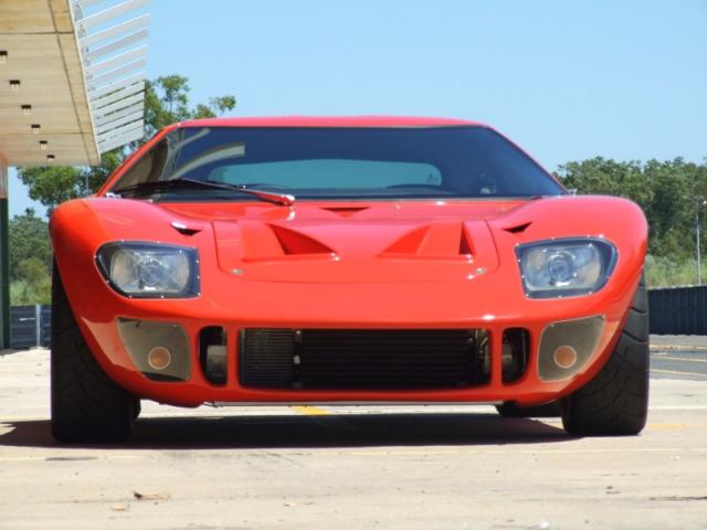

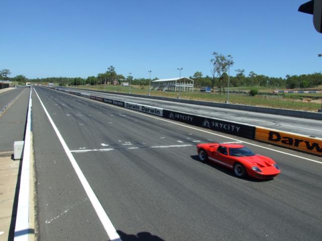

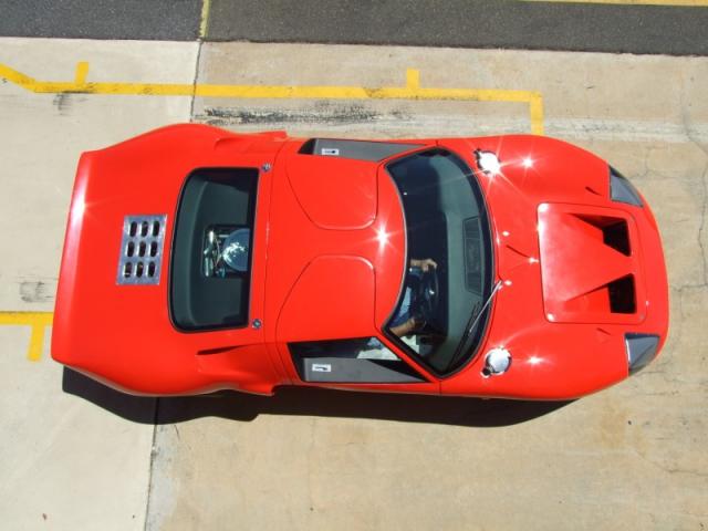

Hope you don't mind, but have added some pics from the first shake down day at the track.
Now get back out to the shed......there's things to do :poke:
cheers
Clayton

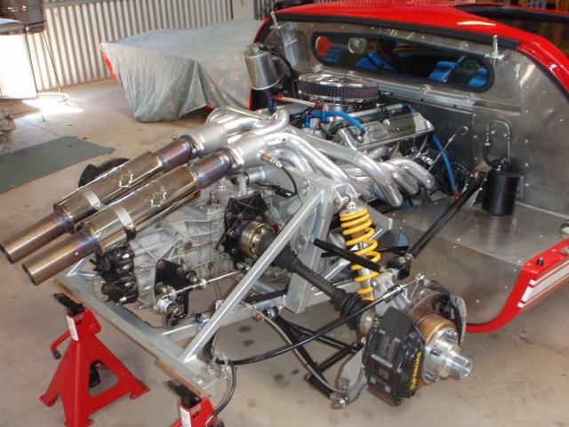

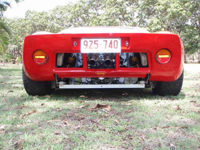

Nice build Udo! I thought catalytic convertors are required down under? Are those small cats in your exhaust before the mufflers?
Congratulation Udo, good to see.
Yes I was wondering about the mufflers(cats) as well.
Did it pass noise and emissions with what is fitted in pic.
Jim
thanks for the kind words guys.
Dave M yes they are cats before the mufflers. they are magnaflow which are the smallest I could find and are ADR (aust design rules compliant.
Hey Jim, as you see it, is how it passed. In the NT the legal requirement is 94 db. I had to put baffles in the mufflers which can be removed for track days. The gear linkage works great by the way, thanks again.
