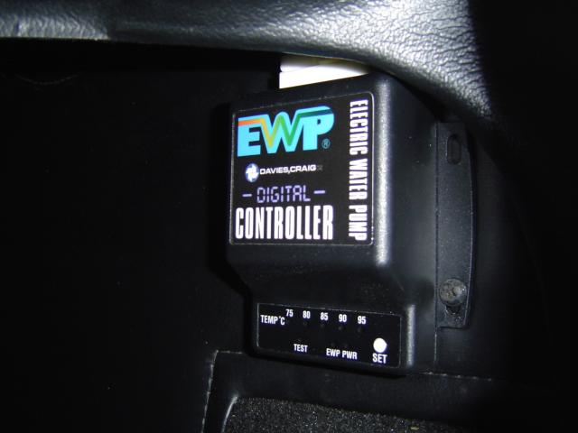

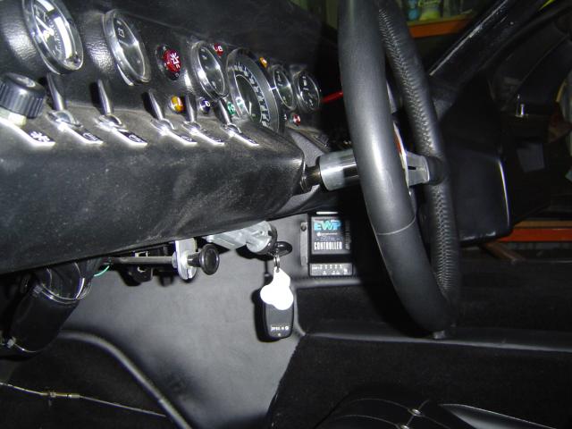

Hi Brett,
I am running the digital water pump controller in my car. Works fine. On warm up cycles water out of the engine in batches to progressively warm the water up. Controller is programable to set cut in point and for full flow and temperature control. I've mounted the controller in the cabin so I can see the stages of operation the pump is at. I am running the 110ltre per minute pump with impeller removed from the original pump and no thermostat. Another feature I like is the pump continues to run after shut down to assist to remove heat soak from the engine for about 2mins.
Andrew E
