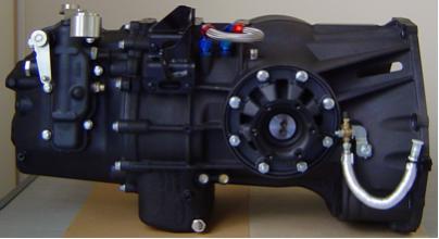

the Ricardo has a internal pump and there are fittings for the oil cooler hoses already on the case. if you are not using a cooler the fittings are connected together with a short hose. the cooler is not require for normal street use but that may depend how hard you push it on the street. the by pass hose in the center of the trans on the top right side. the blue and red fitting with stainless hose.

Mechanical pump. there is a speed sensor and a reverse switch. lik ant trans heat builds up from high loading of the gears . the trans was designed for the 2005 Ford Gt and they did not come with a cooler but there is one available from Ford racing
I am definitely using the cooler. I think most should plan on it. I have not decided on one yet. Ford makes one, so do some GT aftermarket folks. I don't think the proximity of the exhaust should stop you from running a cooler. Just think about where it is located. The SLC has plenty of space. My car.... not so much.
