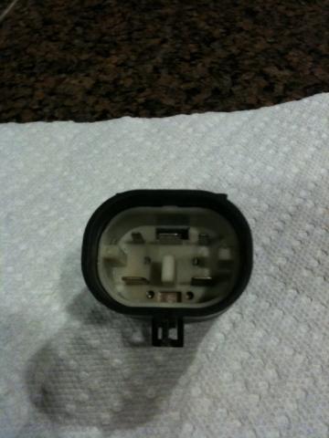

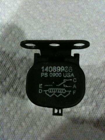

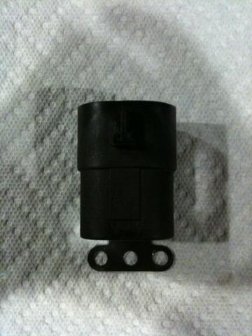

Should've come to you guys sooner. I've been seaching all day for a new relay switch to replace one that went bad yesterday.
I run two Mallory fuel pumps for may EFI and each one has a relay switch. I was given these two relays and have no idea where to purchase them.
The only way I can describe it is that it's a pretty standard 5 pole relay but it's the type that has the snap together plug with a ribbed rubber seal. Basically a weatherized push lock connector \ relay.
For the life of me I can not find anything remotely similar. I don't know the name or manufacturer, ie Bosch :shrug: . It does have a part number and diagram but nothing to identify it with. It's oval shaped and about 1.5 times the size of your standard cubed shaped Bosch.
If you can point me in the right direction I would be most grateful :2thumbsup:

Its a fairly common GM relay used on 88-07 trucks & cars for a variety of things like Fuel Pump, Cooling Fan, A/C, Foglamp, Starter, MAF etc.
Hit your local NAPA, it looks like part #'s ECH-AR279 or MPE AR279SB are a direct crossover, but I'd take the old one for a comparison match.

OMG, you guys are the best!! Ever have one of those days when anything you do makes you look like an idiot :jester: ...I had been searching Google all day with a '2' instead of '3' in the part number :furious:
