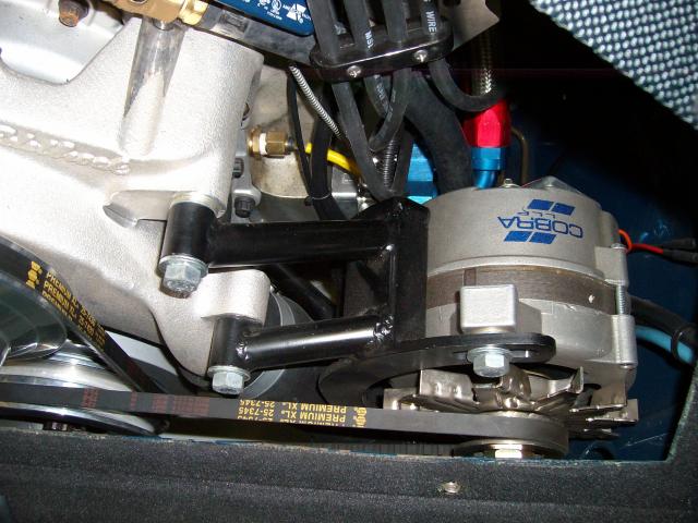

Mark,
Couldn't figure how to add pics to response to your PM so am posting here.
Damper is a BHJ, H20 pulley is a 6" "custom" but, Olthoff should be able to supply the pulley as well as the belt tensioning set up shown in pics below.
How are you coming along? Eager to see some pics as you progress.
Steve P2125
